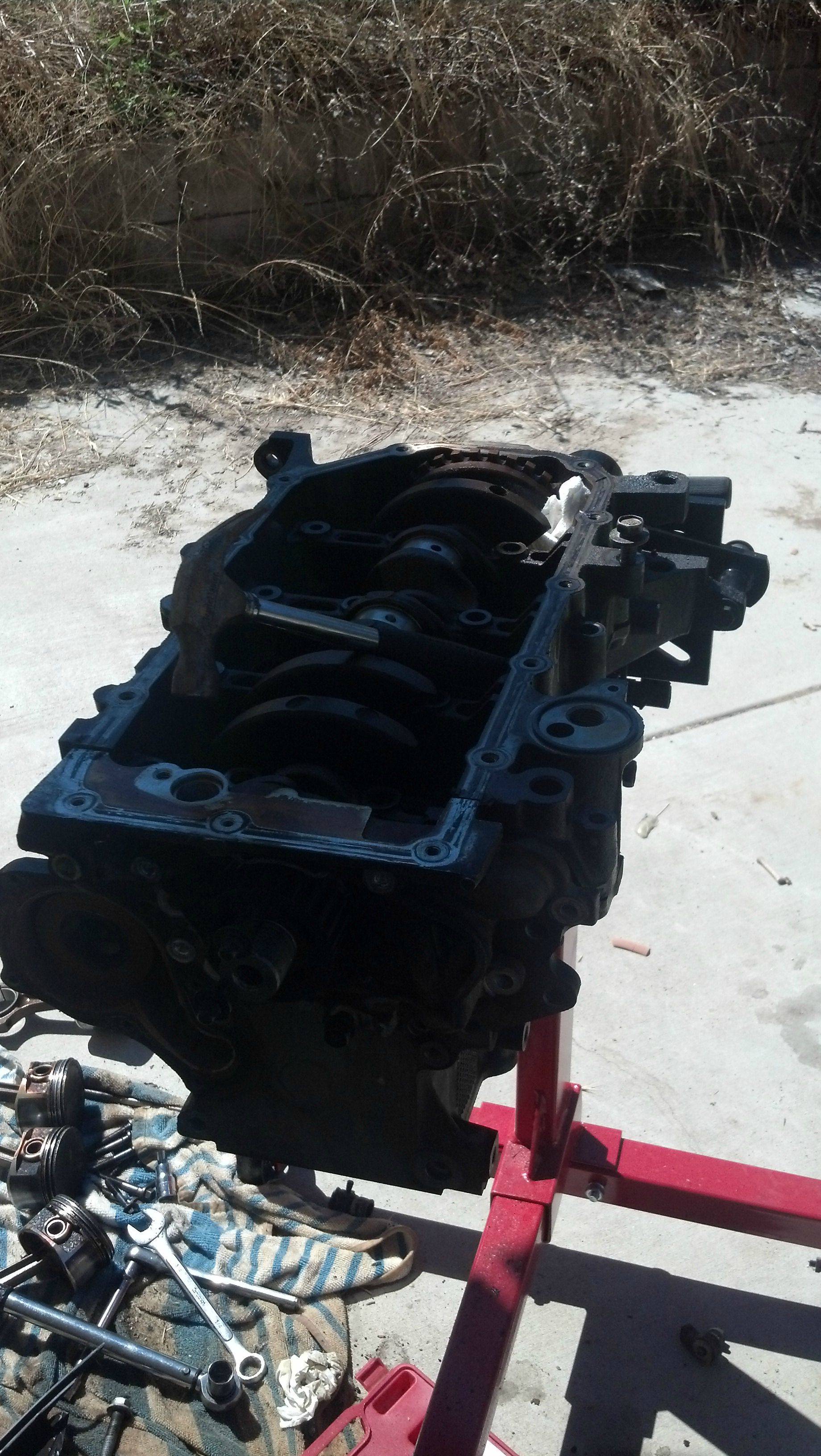

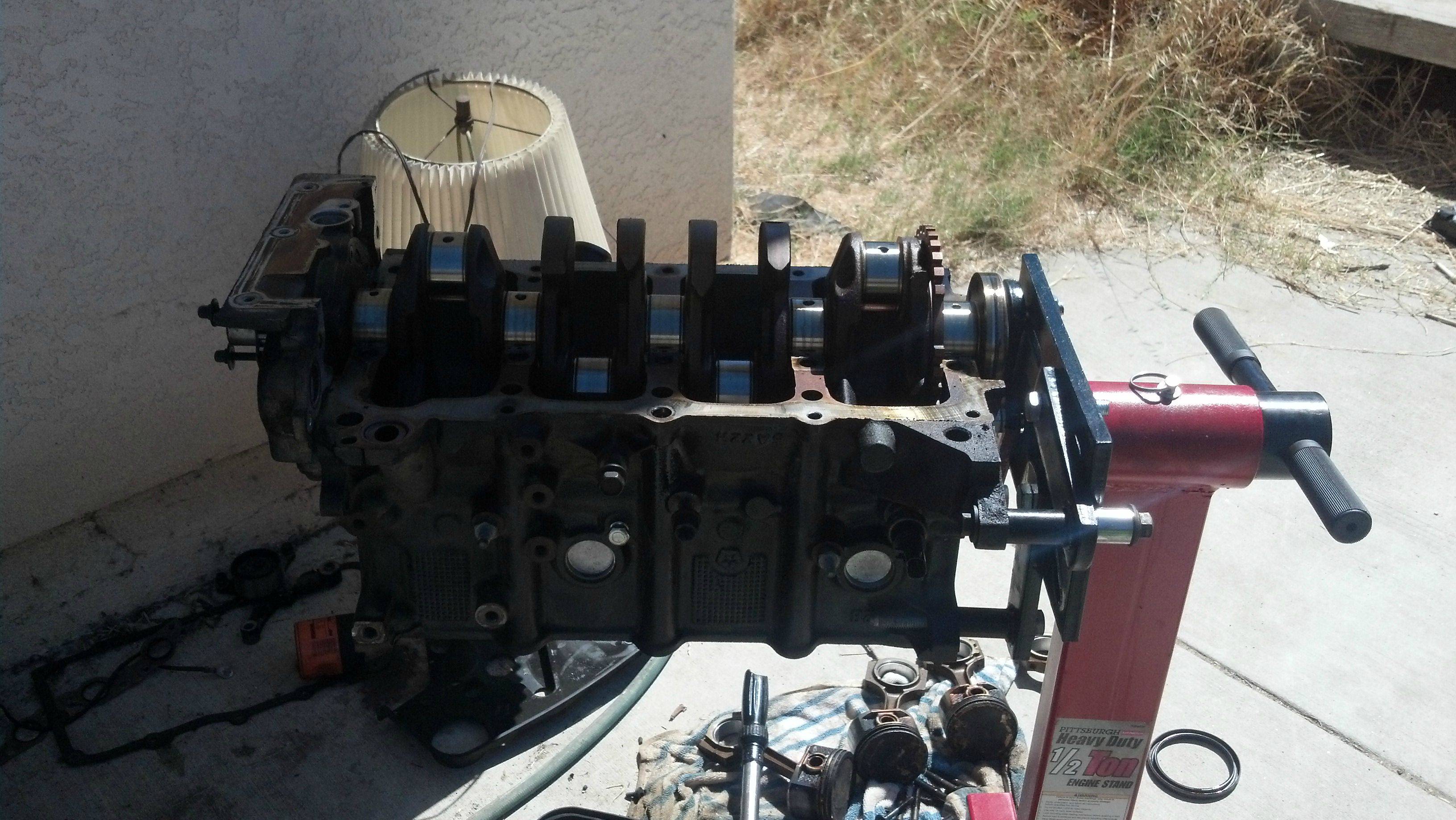

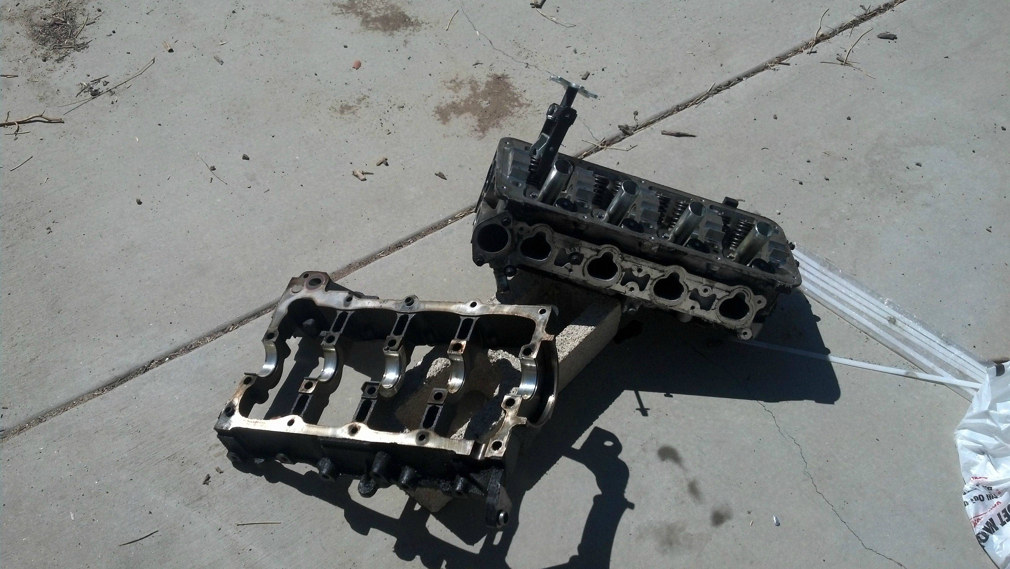

Hey man Im currently in the process of rebuilding my 05's engine. Ive gotten pretty much everything off the block except the crank sprocket is holding me back. After I took off the crank pulley I stupidly assumed that I could take the crank sprocket off with the same tool....ended up chipping it so I have to buy a new one which is only $25 but still.....Anyways you should click on this link http://www.ertyu.org/steven_nikkel/n...2000/EPL_9.pdf Its the service manual for the year of your car. Go to page 48. You'll see that you need a special tool to get this part off and another to get it back on again. The one to remove it is Special tool 6793 and C-4685-C2. To install you need special tool 6792. As you can see in the pictures im at a standstill. I refuse to buy the special tool for removal because I firmly believe that I can adapt the crank pulley puller with some long bolts to get the job done. If I do this then I will post more pics Crank Sprocket Removal and Replacement-dv1y983.jpg Crank Sprocket Removal and Replacement-bo4gsbv.jpg

by the way, the bolts you see sticking out my crank sprocket are the intake manifold bolts. I was trying to see if they would be long enough to use but they weren't.
