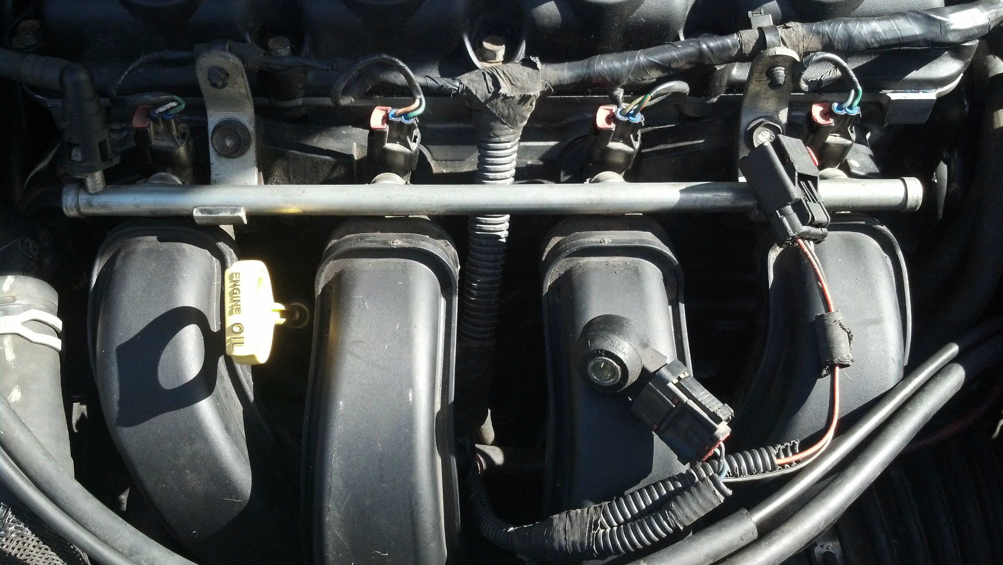

I am almost done putting my neon back together but I cant remember where the knock sensor gets connected to on the block. There is also one more connector that I cannot find where it goes either. Here are the pictures. I have a 2005 neon sxt automatic

Map or access stuff. I know that the harness that slides between the intake is for the starter/ map/knock/ac

There should be a bolt hole in the block right next to the dipstick for the knock sensor. The other connector I believe is for the MAP sensor in the intake manifold.

Found where the knock sensor goes (thank you richards83). The other one is connected to the crank angle sensor. Purrs like a kitten now.....but doesn't want to move.
