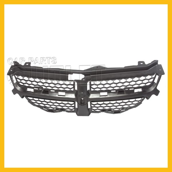

So my brother has a 05 base model neon. He always backs into spots at his work. He works at a department store and came out one day to discover his grill was damaged. My guess is some geezer backed into it and either didn't notice or just took off. So anyway do I have to remove the front bumper to replace the mesh inserts or can I pop off the chrome trim and get it from there. Amazingly nothing else was damaged except one section of the mesh almost looks like someone kicked it in.

those "mesh inserts" are all one piece, with the stud holding the emblem running through it.
http://www.ebay.com/itm/2003-2005-Do...3a8301&vxp=mtr
off with the bumper!
