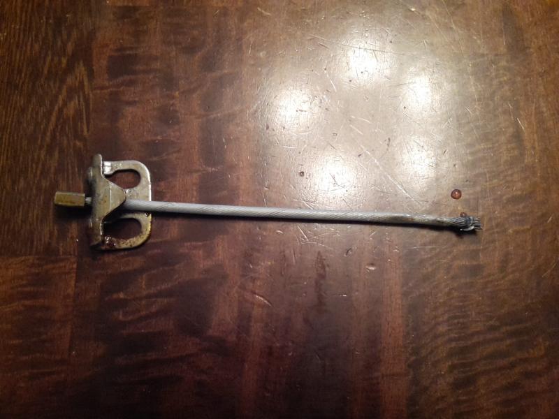

Hello all, I've got a 2000 Dodge Neon SE. The parking brake is broken. The parking brake cables from the rear drums to the handle are fine, but the cable/equalizer(?) that connects the brake cables to the handle is broken.
Here is the broken cable.

This is a diagram I found here. The part I'm looking for is number 6 in the diagram. The site doesn't have this part listed and I've tried contacting them, unsuccessfully. What is this part called, and where do I find one? I have already searched all the online sites I know of, called dealers, been to the local part shops, and I can't seem to find a junk yard/pick-n-pull in the area that has a neon on the lot...

Thank you for the response. Because this part does not look like the part I pulled out I am not sure how it works. Looking at it, it looks like the cable for the other side connects directly to this cable? Or do I have to replace the other side too?

So I ended up going to a pick and pull and got the part for $5. Not bad at all. Thanks guys!!
