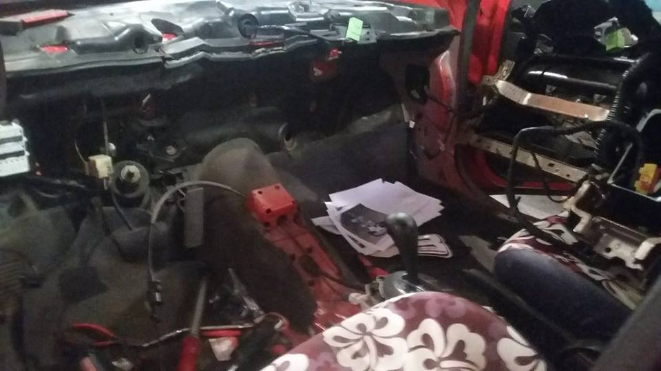

Took 5 hours but managed to get the box out of the car man it is crazy the amount of stuff to remove. It really sucked. Luckily my dads a TV repairman and has an Ultimate set of tools.

This is crazy

Good grief, it might have been easier to just jack the dash up & take the car apart. Looks like Gomer has been in there. Remember when he (EDIT: WOOOOPS I believe it was Goober, not Gomer) that took the Nash apart & put it back together in the Court House!!!! You sure are a Super Dad!!!

Well I have noticed that the evaporator in the box is leaking also. There is oil in bottom of the box under it too. I ordered one of those too. So it looks like either way I needed to pull the box.
Thanks for the help
