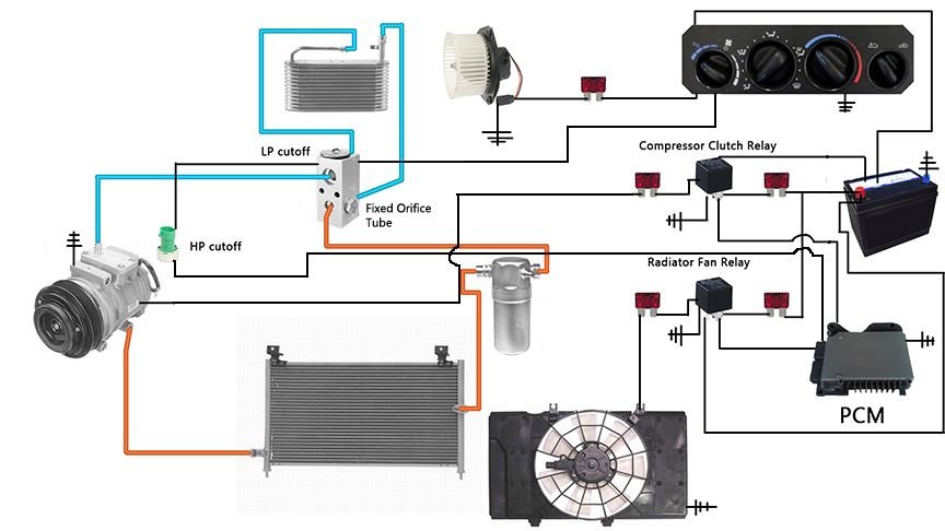

I made this a while back. It's cartoonish, but useful for diagnosing AC failures.
