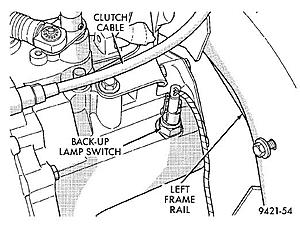

Originally Posted by Sara Cookson
where is that?
On the automatic transmission, is it part of the park/neutral switch on the transmission.
