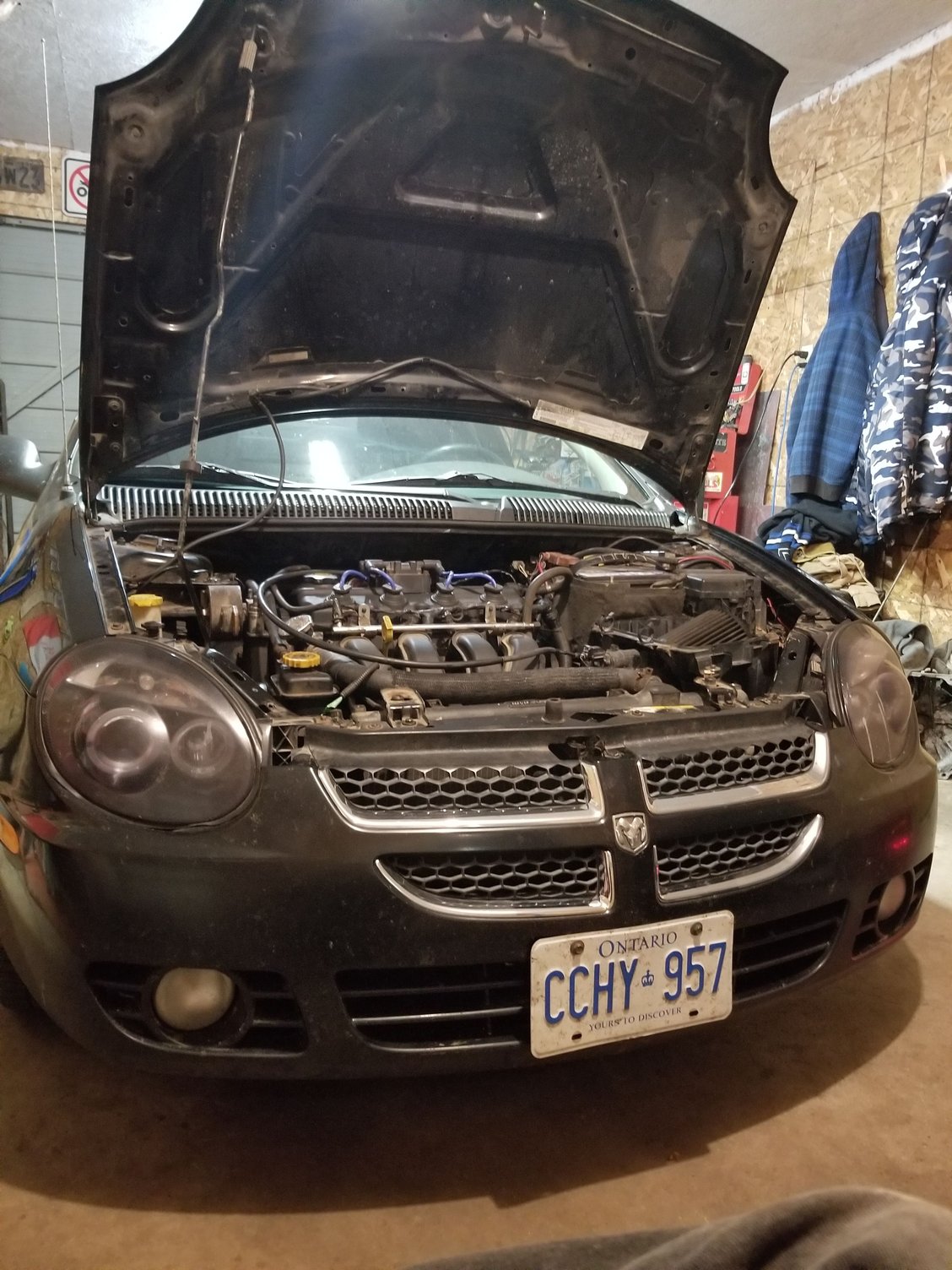

So i bought an 03 r/t from a guy who i no and he sed its mint absolutely mint (should have been first sign to run) so i drove it home and in first month had to replace all barring rear lateral links rebuilt calipers new fron control arms basically everything and then a transmission the clutch just everything so it went good for a bit i raced a frind ( at an abandoned airport ) at 6500 rpm the car ost all power entered limp mode shut off restarted and fine but p0016 p0344 p0340 p0399 **** went down hill from there so i found out he did timming kit from freeking ebay so i replaced with oem kit put a new rebuilt professionally built top end ported n all new cam new cam sensor and magnet new crank sensor (not mopar tho) new coil packs 3 to be exact new plugs new wires rebuilt exaust new high flow cat 2 1/2 inch pipe front to back new computer (pcm) checked signals from wire harness checked n replaced grounds like i have done everything by the book tone ring is solid n not damaged im 4000$ into this f...ing thing and still owe 500 on it got light off drove like grama for an hour to shop for etest passed left parking lot like a pissed off teenager hit 4500 rpm it started bucking hit 5000 rpm n bam p0339 sed screw it n punched it more it took of like a 3 year old seeing freddy cougar in a dream if i clear code i can drive under 4000 rpm no problem above that it bucks n code comes back i am all outa ideas and ready to burn this thing someone please help me i dont no what to do anymore and need it working my son has bws n part of it is he is prone to childhood cancer this is the car we take to appointments 4 a week or if he gets sick to get to hospital as its quick n fuel efficient (normally)

lol always turn my own wrenches i wont let anyone work on my stuff i have been a mechanic for 15years now but any how i have replaced my pcm wire harness new timing kit mopar ckp sensor new cam sensor cam magnet new rebuilt head everything is new and getting proper voltage all grounds are new like i dont get it tone ring is solid but still intermittent signal to ckp sensor and random misfire keeps coming up every now and then p0016 let it warm up it drives fine up till 4000rpm after that the rpm needle drops and the engin stutters and tries to stop but keeps going if you say to hell with it and punch it it stuters till 5000 rpm at that point somthing cicks and the stuter goes away and it goes like a bullet until you shut it off then starts all over again but everything has been replaced i just dont get it
