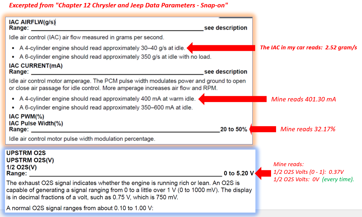

I have eventually taken the car back home. The problem remains - car does not accelerate, struggles to go up any gentle hill. I stumbled across a document on Google and I would appreciate it if you could share your experiences accordingly. Please have a look at the image insert. Thanks.

Excerpted from "Chapter 12 Chrysler and Jeep Data Parameters - Snap-on"
IAC AIRFLW(g/s)
Idle air control (IAC) air flow measured in grams per second.
• A 4-cylinder engine should read approximately 30–40 g/s at idle. The IAC in my car reads 2.52 gram/s and there is no error code.
• A 6-cylinder engine should read approximately 350 g/s at idle with no load.
IAC CURRENT(mA)
Idle air control motor amperage. The PCM pulse width modulates power and ground to open
or close air passage for idle control. More amperage increases air flow and RPM.
• A 4-cylinder engine should read approximately 400 mA at warm idle. The IAC in my car reads 401.30 mA
• A 6-cylinder engine should read approximately 350–600 mA at idle.
IAC PWM(%)
IAC Pulse Width(%)
Range: __________________________________________________ ________20 to 50% The IAC in my car reads 32.17%
Idle air control motor pulse width modulation percentage.
Please help me resolve the problem. I do not wish to junk this car just yet.

I eventually discovered the acceleration problems with my car. The catalytic converter! The diagnostics machine reported Catalyst efficiency: 21%. I replaced catalyst with a used one and the car is back to life. The only PCM error code I have now is P0038 (HO2S Heater control circuit High). The 1/2 O2S Volts (0 - 1) displays 2 V. I am not sure whether the panel beater who did the job of removing the existing catalyst and installing the replacement, tampered with the O2 sensor wiring or whether the sensor got damaged during the job. I will look into this subsequently.
