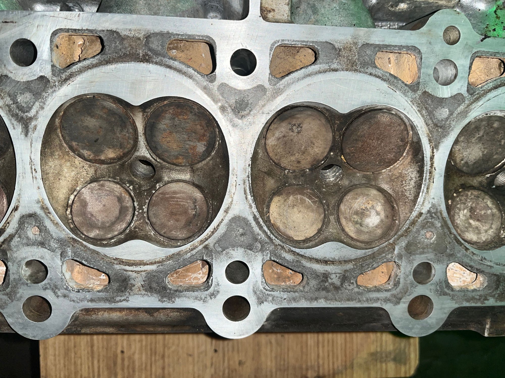

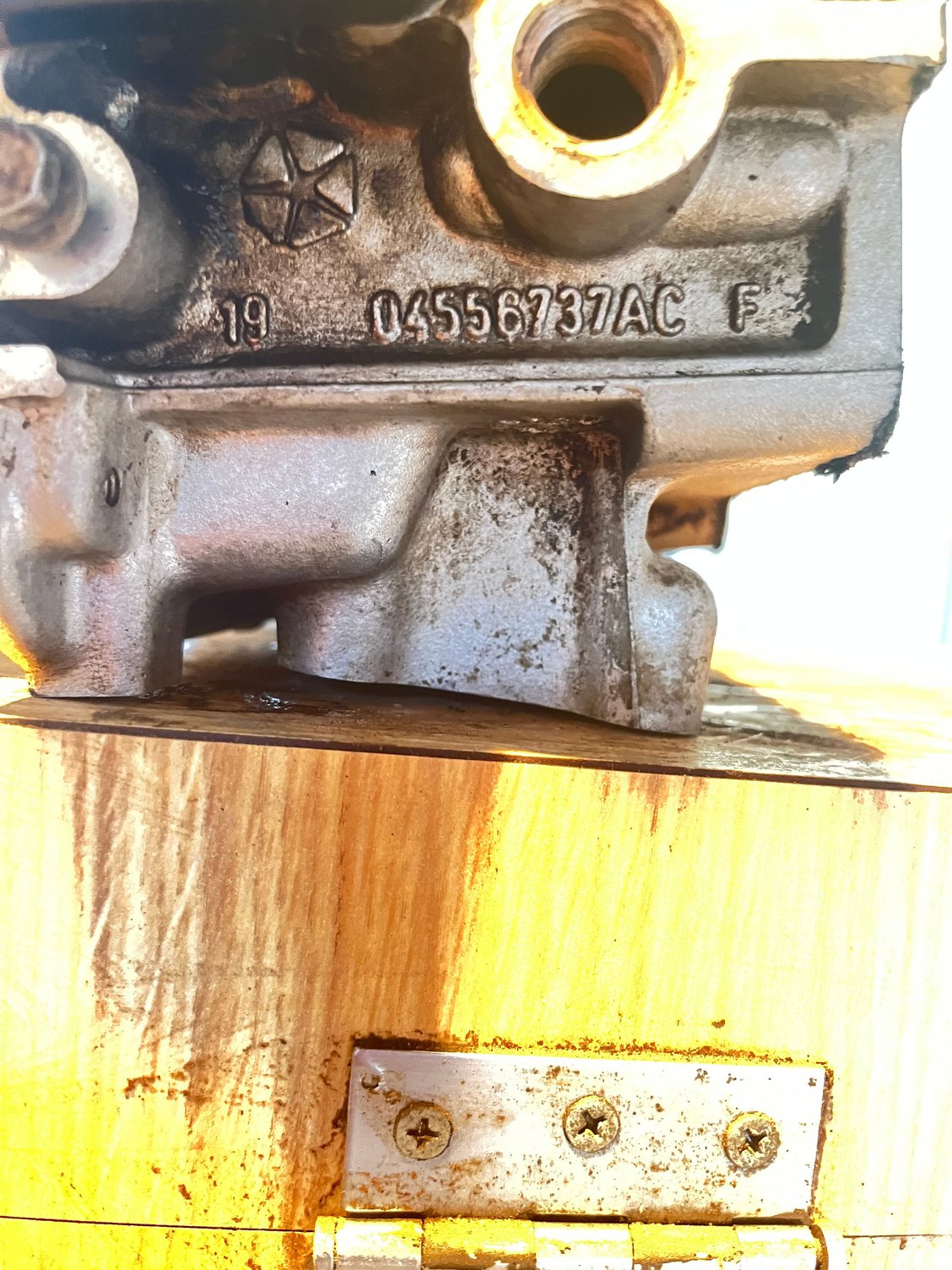

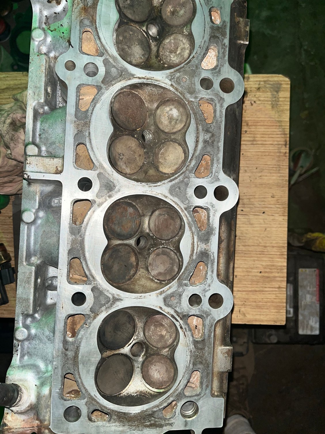

Hello all. I have a question about a 2.0 non turbo set; the lady needed a new water pump but waited to long to do it. When I got the car here, there was water in #3 cylinder. So I told her hopefully just a head gasket(plus water pump). So I got head off and I’m not sure about what I’m seeing, either some ports between the cylinders(on the head) were purposely closed off or got that way from over heating? There are 3 b b sized holes that I started to pick open. I stopped when I saw the cracks between the valves, but I’m sure interested in knowing if they just got like that or not? I will try to post pics, I’m also looking for a used head being this is a charity case, she got 200 to spend and best deal I can find is 260 for a rebuilt without a cam.

Any 2.0 head will work if you wanna take a trip to the junk yard. Just make sure to swap the cam magnet over to the new head.

Will it matter if it has EGR on it? Can I just bolt a plate on that? Thanks for your reply

If you have an egr valve then yes if not then just plate it

And any 2.0 Chrysler head will work from 95 and up
