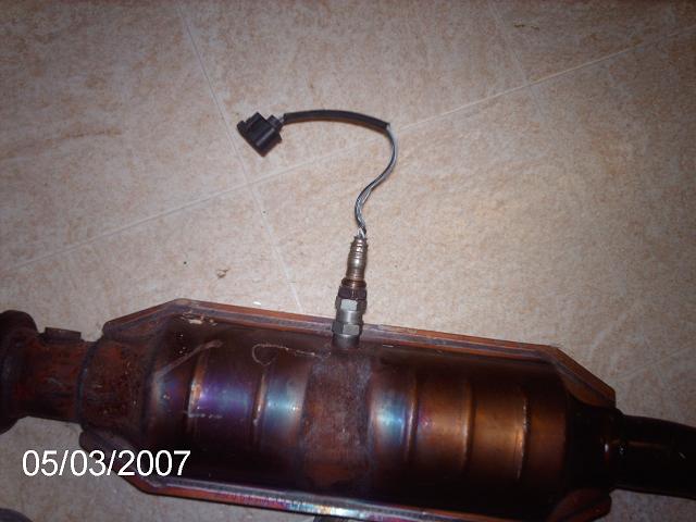

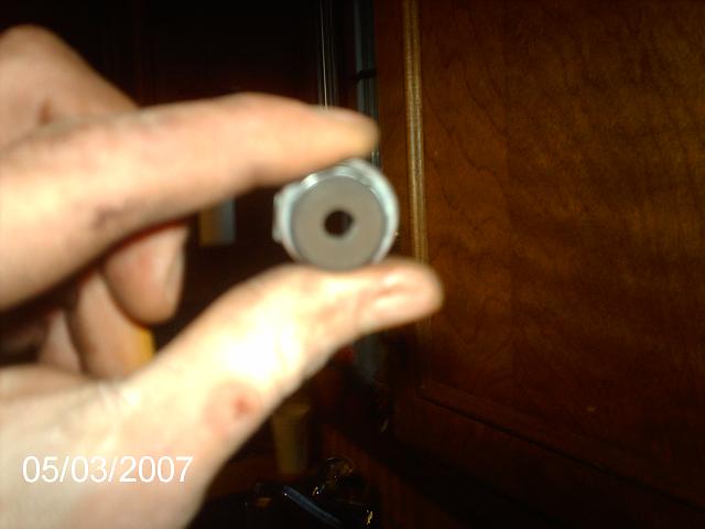

ok here is how the defouler looks mine is dirty since I just pulled it out of the car too take some pics
if you look at the defouler it will only have small hole on the one side like this
all you do isdrill it soand it shouldlook like this
you only need too drill one just make sure you make sure too get all the metal shavings out of the defouler before you install it.
Screw the drilled defouler into the non drilled one then screw that into the bung on your down pipe/cat
here is how is how it should look when your done

put it on the downstream 02 sensor (the one farthest from the engine) wherever it screws in
