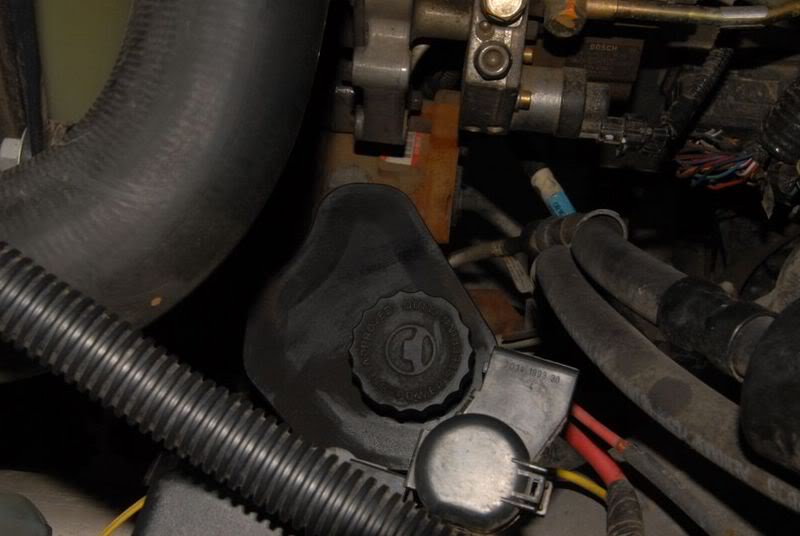

Locate the power steering lines going to the cooler

Remove the power steering cap to allow the fluid to drain freely
