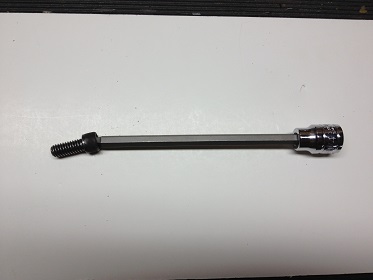

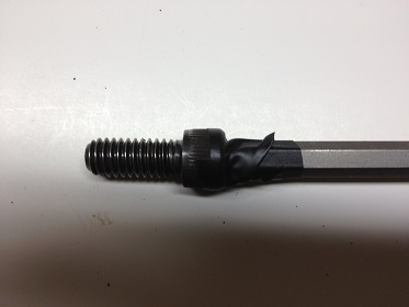

The real deal, however, is the tool. I have attached 3 pictures. Img 1 shows the 6" long "wobble head" 1/4" allen wrench with a 3/8" drive. Img 2 shows the tool inserted in the bolt and the amount of deflection enabled. The 3rd image shows the way I used a small amount of electrical tape around the tool and head of the bolt to make insertion easier.
