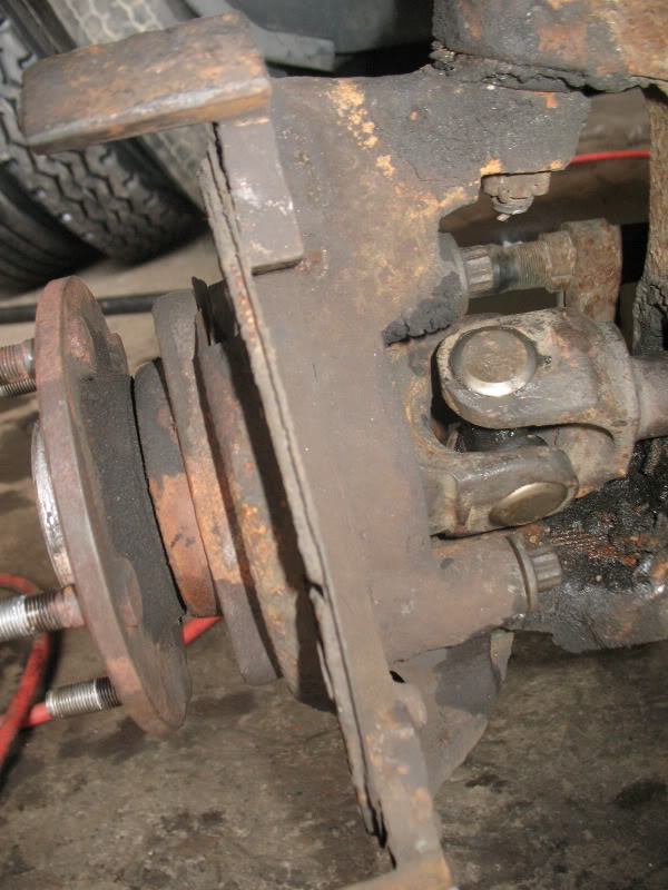

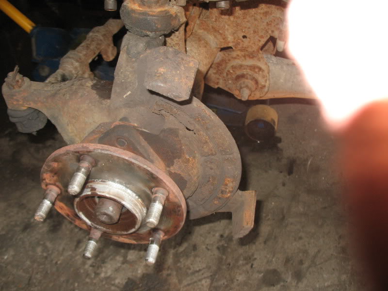

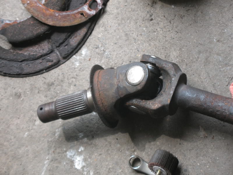

Default Can of worms...typical
So i finally figured out what the noise was coming from the passenger side front wheel...universal joint. Do one, to two of them...then I found that the wheel bearings need to be done too but I cannot afford to do that since I am going to Vegas. We all have priorities.
Here are a few pictures...Hands were a little to greasy to get a bunch.

i see anti-seize, smart move. i put it on both sides of the washer and all over the hub nut and on all contact points between the hub/spindle/stub shaft. i just put mine back together the other day after replacing the driver axle seal and passenger u joint.

Just by looking at those pics, I'd say someone needs to grease their suspension components, and maybe put some anti seize on the hub assembly where it inserts into the knuckle.

some sand blasting or wire wheel work and paint wouldn't hurt either.
from the way you talk about your rust it looks like your trucks suspension has a twin.
