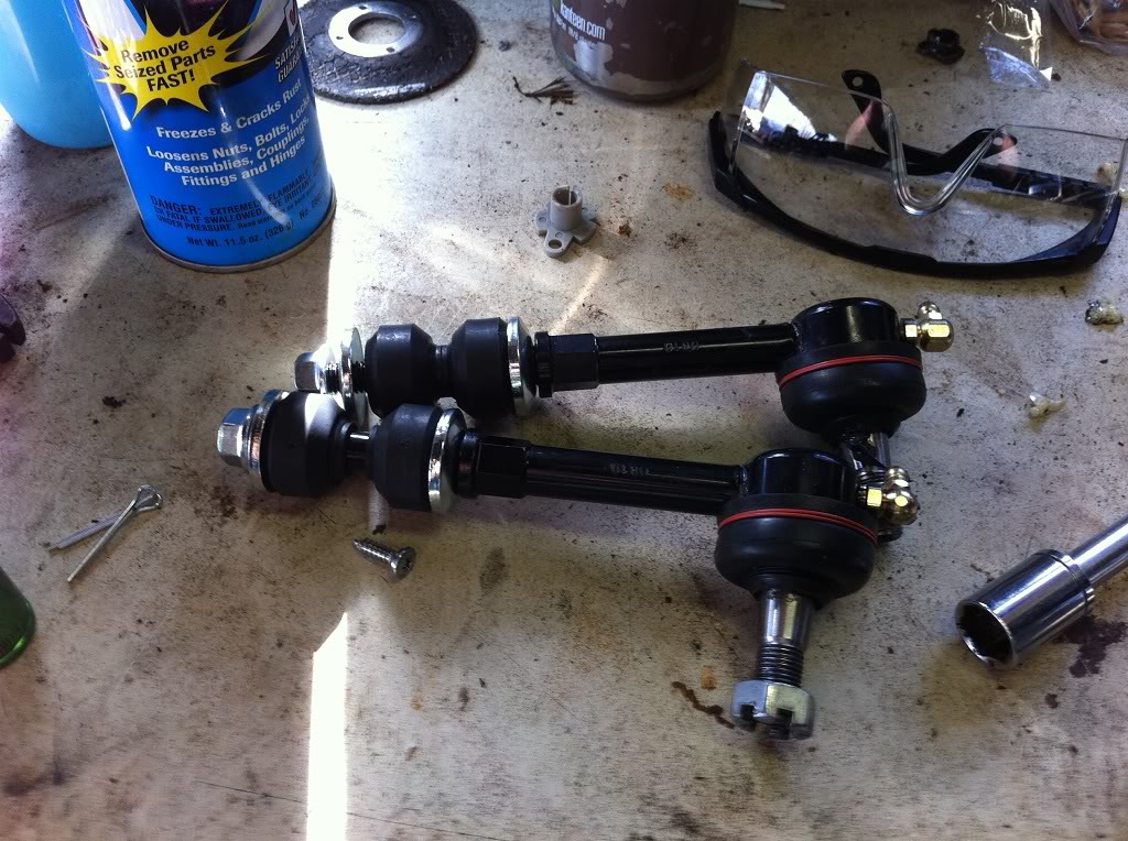

Also got new stabilizer bar links from rock auto. Deeza brand (made in Turkey) greasable links for $21.79 each. These seem
to be decent quality for the price.

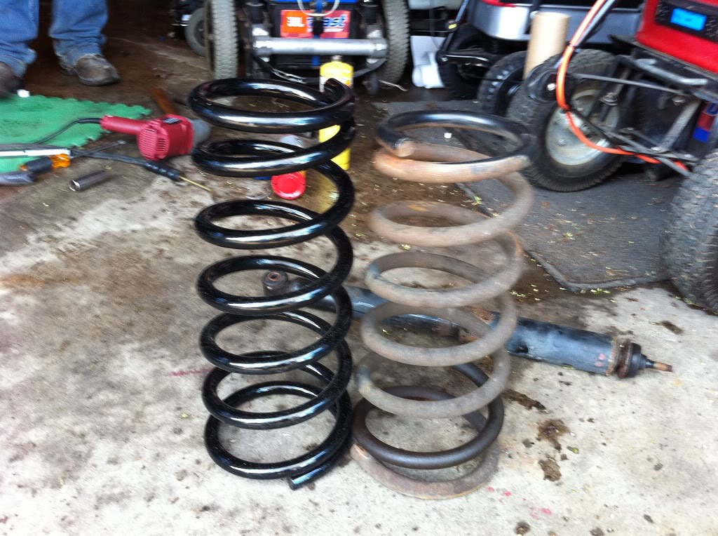

On to the install, I was really surprised with how easy the installation was. The hardest part was the lower shock bolts.
They would not budge without heat.
No spring compression was necessary on the new or old springs at all.

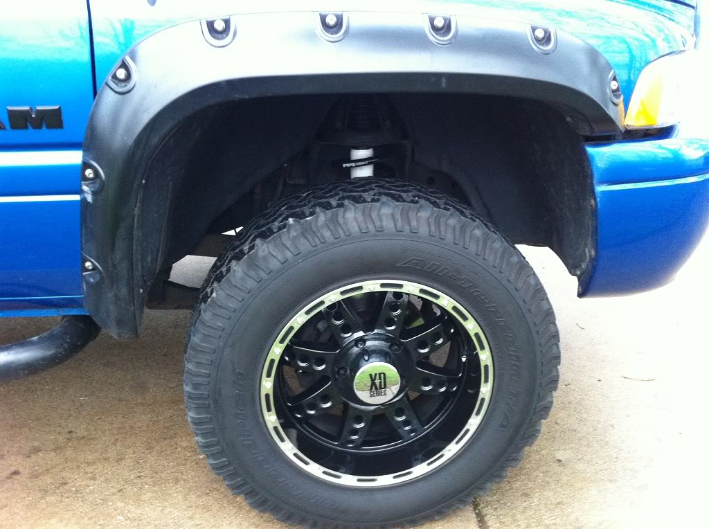

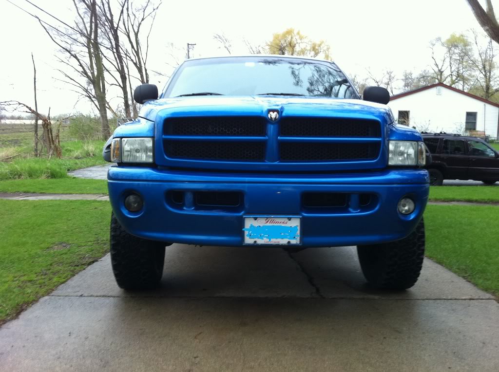

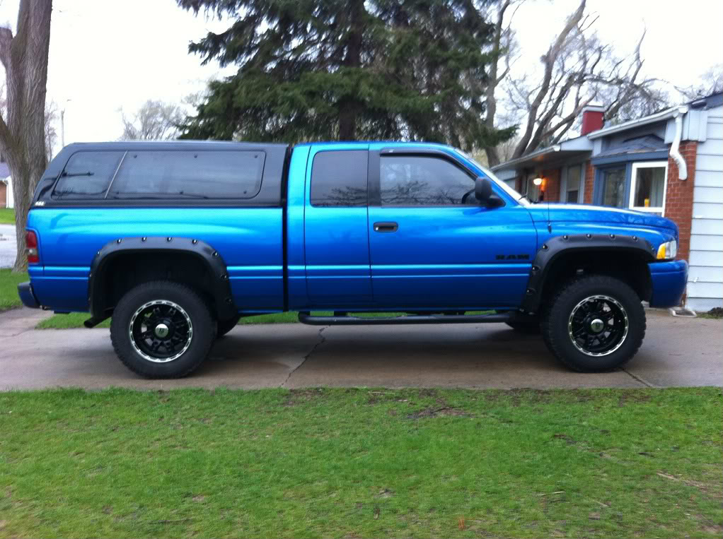

After;
Looks low in the rear because of the incline of the driveway.
Center cap is off because I still need to bust loose the hub nut.
Drives and handles much better now.

thats a beautiful looking truck...looks like it just rolled out of the factory...i wish mine shined like that...im jealous.
But theres something thats puzzling me....your rear wheels, it looks like they are off center a little bit, they face towards the front a little more...Is that the flares giving it that look? have you done a shackle flip?

Thanks, I do put a lot of effort into keeping it looking good.
I see what you mean about the rear axle. I think it looking off center is a combo of the flares and the angle of the pics. It is centered.
