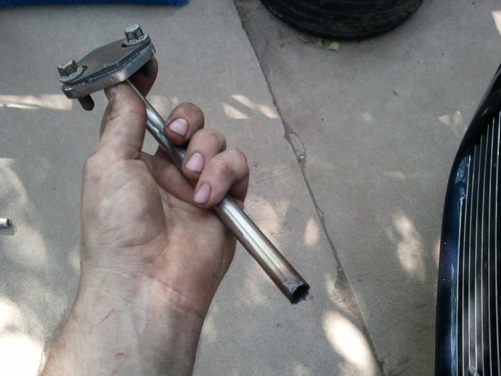

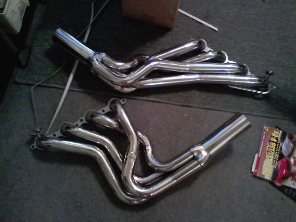

I don't know about these specific headers, but on the whole the eBay header brands are hit or miss it seems. I got some eBay long tubes for my old 99 Z28 and they looked nice and fit well enough, but the ports for the O2 sensors were facing the wrong way and the welds on the emission port tubes were extremely weak. I broke them both off by just having my hands near them when doing mundane things like spark plug changes. It was aggravating to say the least......

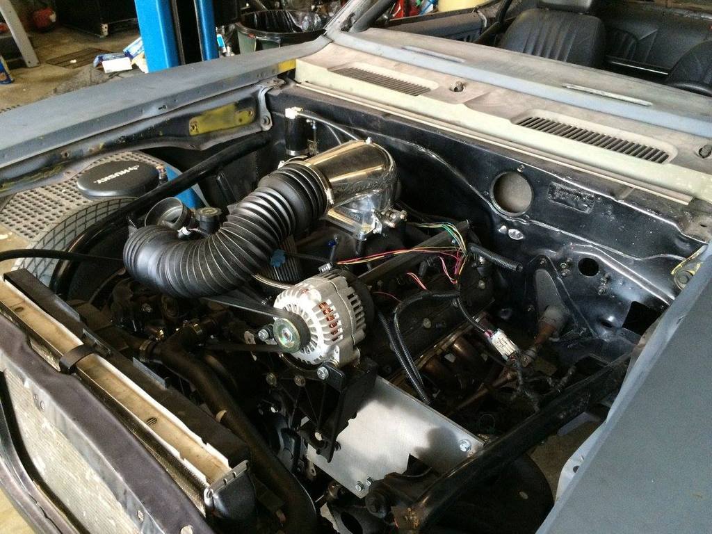

I sold the car they were on and I've kept my other LS1 car mostly stock, so I gave them to a good friend of mine who welded up the emission ports and uses them on his LS swapped 67 Camaro drag car.

Some people have reported warping at the flanges on some headers and / or weak welds on those parts, but I haven't noticed anything like that with any I have come across personally. All in all I would buy some again if I wanted to get some decent, cheap headers, but I would I would keep an eye on any emission tubing welds and be prepared to repair them when they break.
