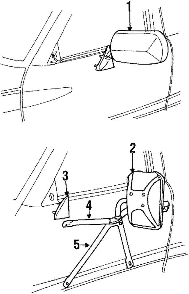

Hey guys,
just wondering if anybody knew of any of these floating around or knew of the technical name for em so that I can search them up online. Want to swap west coast mirrors or tripod mirrors on my truck and don't want to have a gaping hole in my door

Those technically aren't west coast mirrors (west coast mirrors mount like a big rig). Unfortunately you have three choices. 1 is cut the mirror off of a 99 and up mirror and fill it in. 2 custom fab something. Or 3 find a set in the junkyard I could even look around here if you want

Thanks for the reply. Yeah, I know they aren't west coast mirrors lol. Just used that picture as a sample cuz it was the only thing I could really find online clearly showing what I was talking about. Im gonna probably do some sort of home brew custom fit up with some of the parts we have collecting dust on some of the parts trucks we have at the truck shop I work at. I would actually really appreciate if you would be willing to take a look for me. I haven't started looking out here yet, but it seems the number of pick-a-parts keeps getting smaller and smaller here in my area of Ohio.

If it helps you any. The 2001 Ram parts manual shows them under the optional tow mirrors page(figure 1-230). They're called 'COVER, Mirror Flag' and have a part number of 55075445 for the left and 55075444 for the right. Ebay listing for those numbers come back as replacement power mirrors for the 94-97 trucks. Mopar parts sites show them correctly but are discontinued. Good luck in your search.
