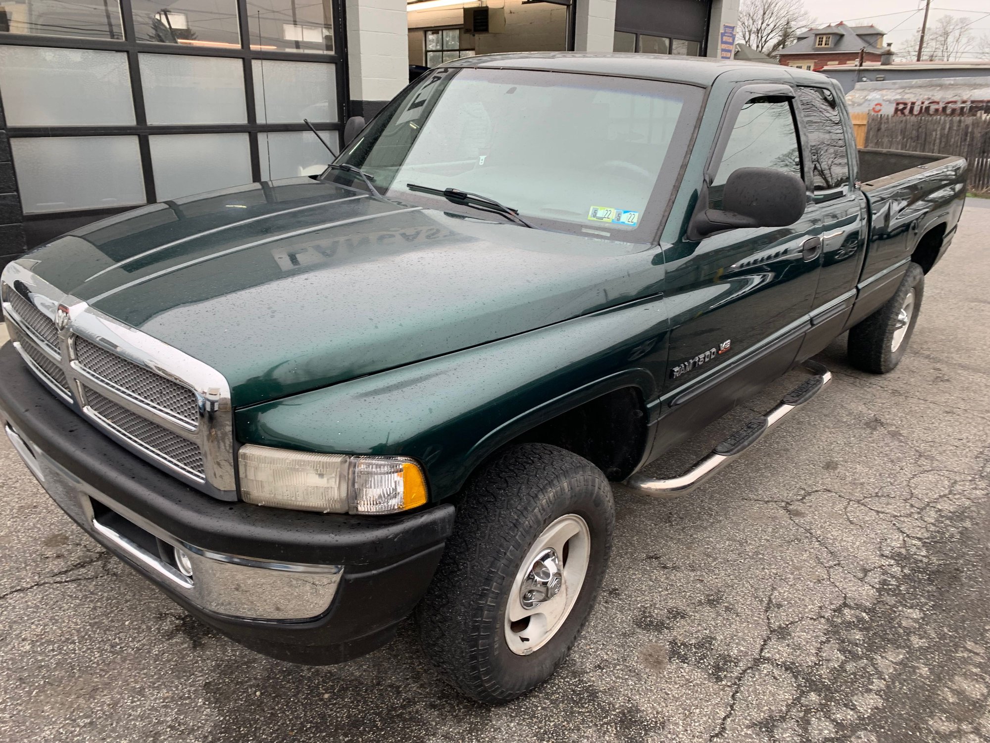

Hi, bought a well maintained 200k mile ‘01 ram 1500 4x4 5.9 gas Laramie. I wanna do a few upgrades, nothing crazy. I want to put 265 75 r16 on, backup camera, and 2 inch leveling kit. I might put 2000 miles a year if city driving on it. I will not be towing or off-roading. Any other suggestions? Maybe how to Ute up loose steering?
