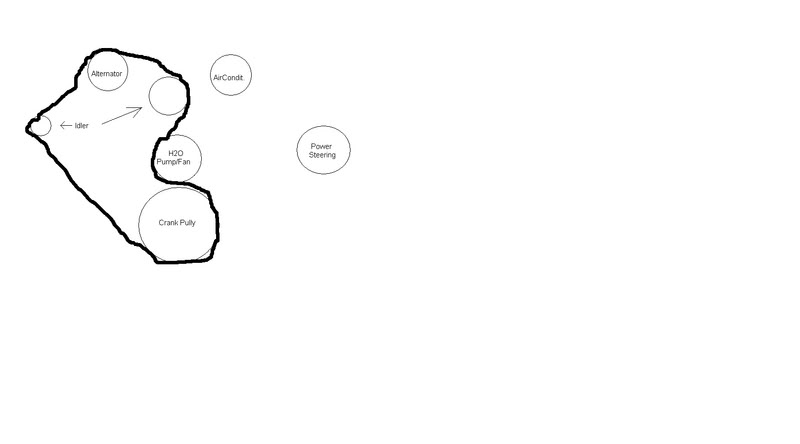

I routed it, checked it, double checked it, triple checked it, and cranked it over, checked to see if it slipped at all...all good, so I started up the truck. It squeeked as it was getting to speed in the first second or so, but after that it was tight and alright. I checked to make sure the waterpump was spinning properly, and that the temp didnt rise. After that was all clear I went for a drive down the boulevard. Oh man was the steering tight as hell, lol. I cranked it up and noticed the pull from 4-5 went a little smoother, seemed to jump a little faster. How much faster, not much, but Im sure Ill find out at the track come the 28th.Either way, cool temp. mod. and Id recomend doing it, for anybody who wants to go straight in a hurry.
crap....I forgot to take a pic of the routing for you guys. Ill just make a diagram.
There
oh yea, if you wanted to know what size to go with I have a 55" 7 rib. I think if I were to buy another one Id try to track down a 54" belt, to see if it wouldnt slip on startup. I couldnt find a 54" but it may be worth it in the long run(as far as longevity of the belt is concerned).

I'm just guessing without going out and looking, but the top center idler pulley looks as if it was pulling the other direction(down) before the switch which now looks like it tensions up now.
I'm guessing it is solid and not spring loaded.

ORIGINAL: Chopper1
yea, that one is solid, the spring loaded one still has the belt on the same side.
