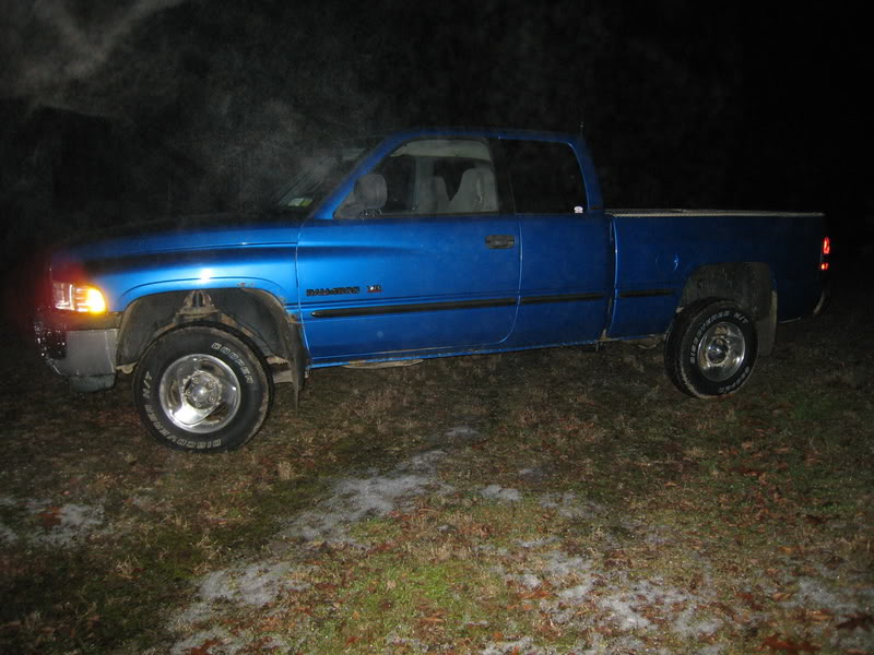

Thanks for the reply and sorry I forgot to specify. It's 4x4. No offroad package. The guy that sold it to me just replaced the tires and he used it more to travel back and forth so maybe he put a more "road friendly" tire on it? Here's a picture:

285/75/16 are the biggest u can put on it without it rubbing on anything

245/75/16's came stock on 4x4 trucks. 265/75r16's were an option. 285/75r16 is the biggest you can stuff under there with the stock rims, and you may still get some slight rubbing on the control arms at full lock depending on how aggressive of a tire you buy
