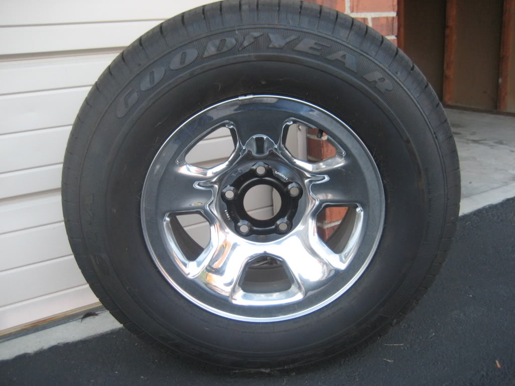

are your looking for a more stock look?? if so stock Tire Diameter: 245/75/16= 30.5........ so 265/70/17=30.6 that's very close tire Diameter. that would give you a nice ride and not throw off the speedo
do they look like this

yes look exactly

ok.. well those tires are 265/70/17... i hope that i've helped
[/url]
i groofed 265/70/17=31.6
so 245/75/16=30.5
and 245/70/17=30.5
so they are the same
sorry i hope you see this be for buying,, sorry again
