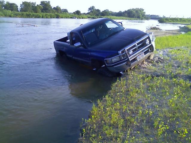

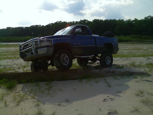

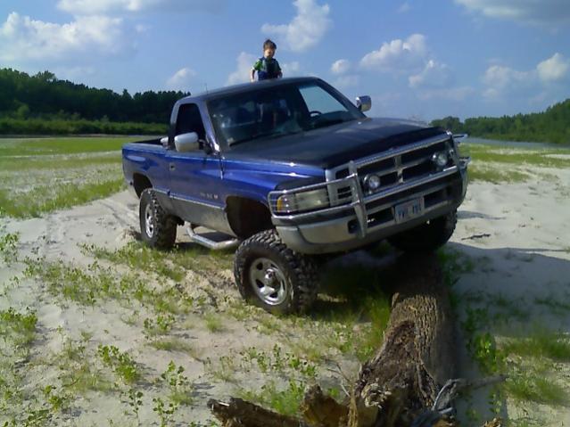

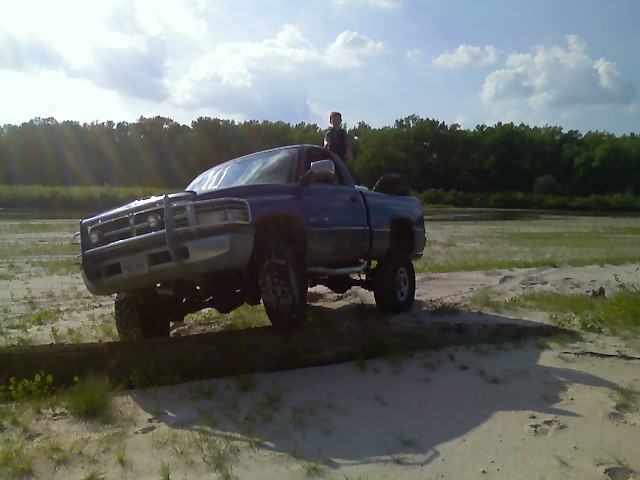

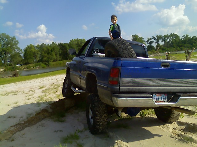

you got any pics of this bada** lift lol

Yea here are a few from my last river trip. Was fun till I burried it in the current some a hole was flying down the sand bar and i had to stop in front of a 2 foot bank and back tire broke loose. But still a great day.

what kind of tires are those , truck is sweet man !!!

Thanks there cooper discoverer STT's Awesome in snow mud and sand.
