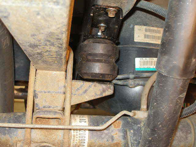

here's a pic showing the normal timbren install with a gap so you get normal ride and no lift. it acts as a helper spring. you put them on the rear to haul a heavier load with little/no sag, including heavy tongue weight on a trailer. if you don't have a gap, you'll get a very very stiff and uncomfortable empty ride.
as said above, you would put them on the front only for snow plow or very heavy bumper. i have rear only, no front. i don't know how they would ride or drive.
