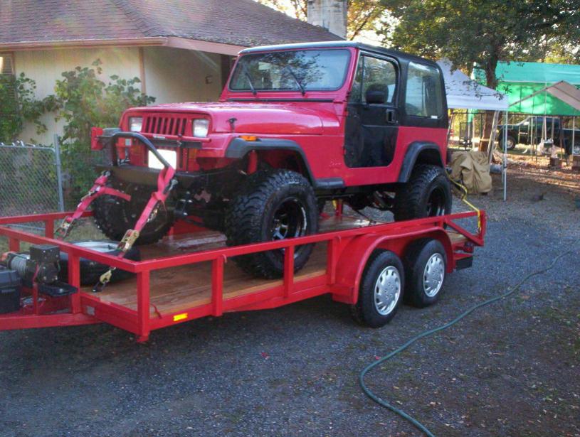

im used to turds, i just spent 2 months rebuilding a wrangler, and not done yet.
