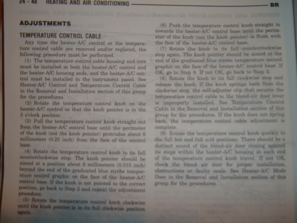

This is out of my 98 FSM, and is worth a try. I'm flushing my heater core today first (as I have the hoses already disconnected) then I'm try this (just now found it) I hope it is legible.Name:  DSCF0460.jpg

I have heat but its just not as hot as it should be like alot of people state....good info its definetly worth a shot, thanks

Excellent. I'm going to try this.
