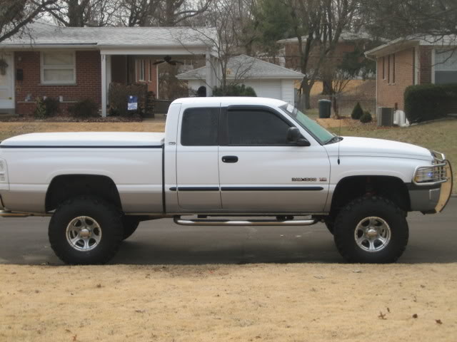

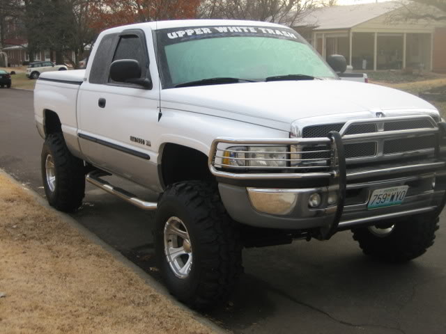

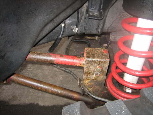

Originally Posted by olyelr
Kindschi, do you really have an 8" total lift? I'm not gonna call you a liar or anything, but if you had 8" of lift you would be clearing 38" tsl's with more room than that. Honestly, that looks like a coil spacer on stock height springs... maybe 3" springs. Nice looking truck anyhow!
Yes in the front I have 8inch. My sig pic is before I added the 3 inch coil spring spacers, I guess its alittle misleading.. I liked the pic to much to update. And I dont think I have any pics with the coil spring spacers at all since my gallery wont let me upload anymore since its full.. So I just went out and took some more... Oh, Thanks for the compliment! Love your sig pic!
PS: I got the lift off another truck and the paint so the paint on the lift is not the best. Its rusted, I plan on painting it, one of those outta sight outta mind kinda things. Since its hard to see the lift I never think about it but im gonna have to paint it soon after seeing this pic. Ohh and the zip tie has been cut, ran out there and cut it a min ago.
