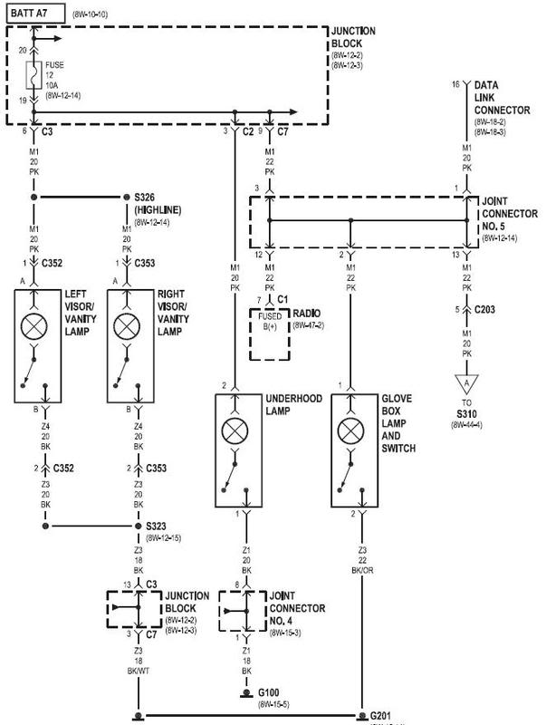

Here is the schematic:

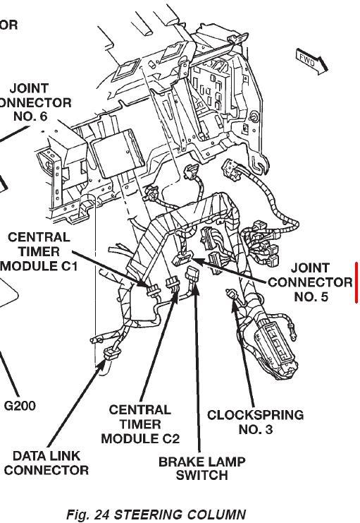

Check Joint Connector 5 (under the steering column). Here is where it is located:

You could also check to see if there is power getting to the socket in Fuse 12. Pull the fuse, and probe each side. One side (the downstream side) should be zero. The other size should be 12V. If not... it means the problem is further upstream. If you do have 12V it will be further downstream.
