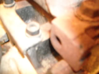

7. Sitting under the passenger side exhaust manifold, reach behind the manifold and feel for the sensor, to locate it. (WOW, after reading that a second time, I can see how that can be taken WAAYY out of context!!)
Here is a pic to show what it looks like on the motor.

8. Using a 1/2'' open end wrench (I could fit one in there) or a 1/4'' hex, loosen the bolts.

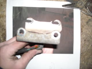

11. Using a RotoZip, Dremel, or whatever, slot the sensor so it looks like the one in the picture below. (I am holding a non-modded sensor up to a picture I got from Dodge T*lk)

11. Shave off the rough edges of the holes with a file.
12. Clean off the metal shavings that may have acclumilated on the bottom of the sensor with Electric parts cleaner.
