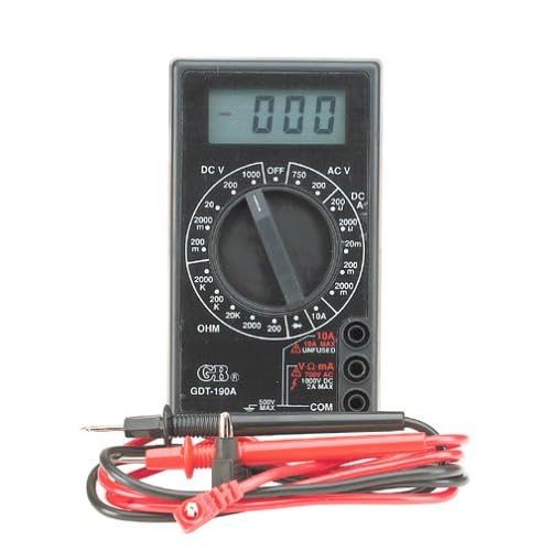

i have never used a multimeter and i need to know what to set everything on
here is the one im working with

i found a thread on her to use the 20k ohms, but which hole should the rad lead be in?

the lower red hole looks like the port for using the ohm setting, its hard to tell from the small pic. the symbol looks like a little hat.

helms is right, it's the bottom red port. I just happen to be looking at the exact same meter. And don't forget to turn the damn thing off when you're done using it. It does not have auto shutoff. You'll be pissed next time you go to use it and it doesn't work because the battery is dead.

+1 for the second red port.
The black should be in the COM (Common, another name for Ground) and the red should be in the middle (second red) hole. You see that little headset or earmuffs looking icon, between "V" for volts and "mA" for milliamps? That is the symbol for ohms.
EDIT: I know this multimeter picture isn't exactly the same as the one he has (must be an older version of the same model), but its close enough to make the point.

ok, where does it need to be set at for the volts?.......bottom red, then where on the switch?
