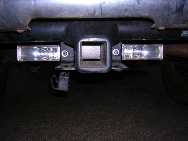

when you get it all sorted out, and decide that the stock backup light still suck, look into a set of aux lights like this
