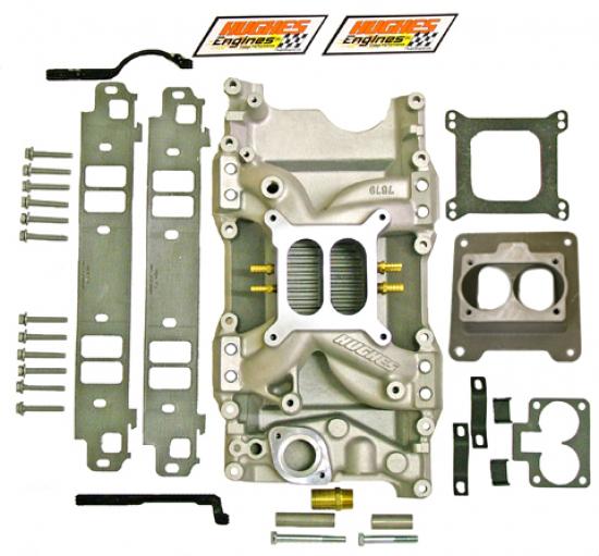

Originally Posted by Hahns5.2
According the to picture on Hughes website, the Airgap does have a AIT hole...
No, no hole. If you download the instructions, it has a little FYI on that.
What is the threaded hole in the runner on this one?

Speaking of holes. For my e-fans i have teh sensor that goes into the coolent. I assume i will need a spliter for that so i can run that and my stock temp gauge? Where can i get a spliter if I am correct.
And I'm pretty sure mine has that whole thats in the pic
That is not the same intake. It's also missing one of the coolant temp sensor ports. Some of those threaded bosses are / were for stand-offs but, I haven't seen that pic that showed that NPT-looking hole there. It may be an older design.
I have one, and, there's no NPT for the sensor.
Another option is to use a TEE fitting on a heater hose, It's what I'm using for my aftermarket temp gauge, It's not as accurate though. The M1 I think has 3 temp ports but the plugs were too seized (steel in aluminum ) to remove them... A hardware store or parts store should have what you need for fittings.

[URL="http://www.hughesengines.com/Upload/productInstructions/FI_AirGap_Instructions_Aug2009.pdf"]
Check out page six; third photo down- no AIT sensor.
Mine has the hole there

Posts: 1,093
Likes: 6
From: Near NY for another contract
I think that's an older one. How long have you had it? As far as I as informed at Hughes, I though they did away with those holes.
