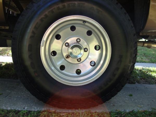

it was in the military storage. I have no clue how it got bent, they had it on the machine for balance and called me over to show it to me. Its on the inside of the rim kinda hard to get a pic of it but when spinning you can really see how much it affects the wheel.
I think the rims on the truck are Pacer aluminium rims 16x8.5

hey! i have those same lug nuts.
DAMN! that looks pricey! Good luck finding those at a bone yard. I thought military takes care of any damage? when my sister had her car shipped to germany, Air force dinged it a little and they paid for it.
