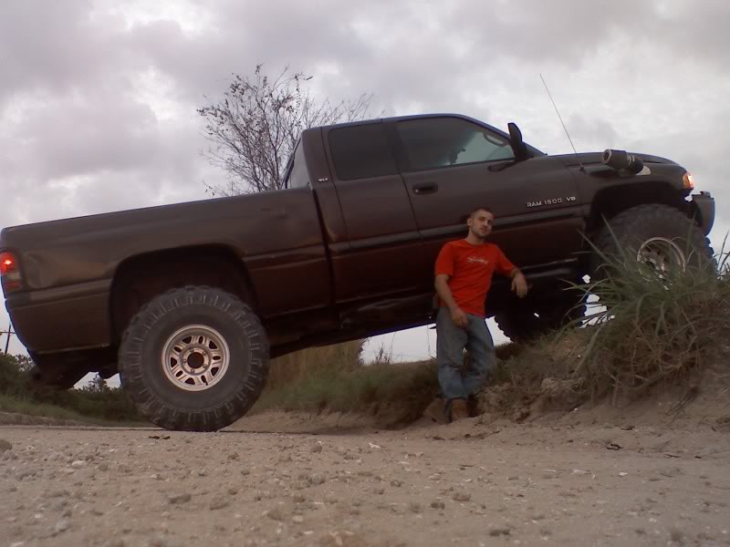

Originally Posted by meanwhitemopar
lets see some pics of this beast that dont get stuck? you know i love mud trucks...

you have to paste it in the little mountain icon

how much lift do you have to run 38s, they look like they are stuffed into your fenders and looks like you cant turn, might just be the angle your at though.
Im not really digging the air filter out the side, wouldnt it get clogged with mud and defeat the purpose of it.

im running 38's with stock axles and 4.56 gears. I can roast the tires so I personally wouldn't go any higher than 4.56's... but I drive a lot of road too, so if its only a mud truck and will never really be reaching 70 mph than i would get 4.88's. Yeah ur lift looks tiny cuz with my 38's its obvious I have tons of clearance.
