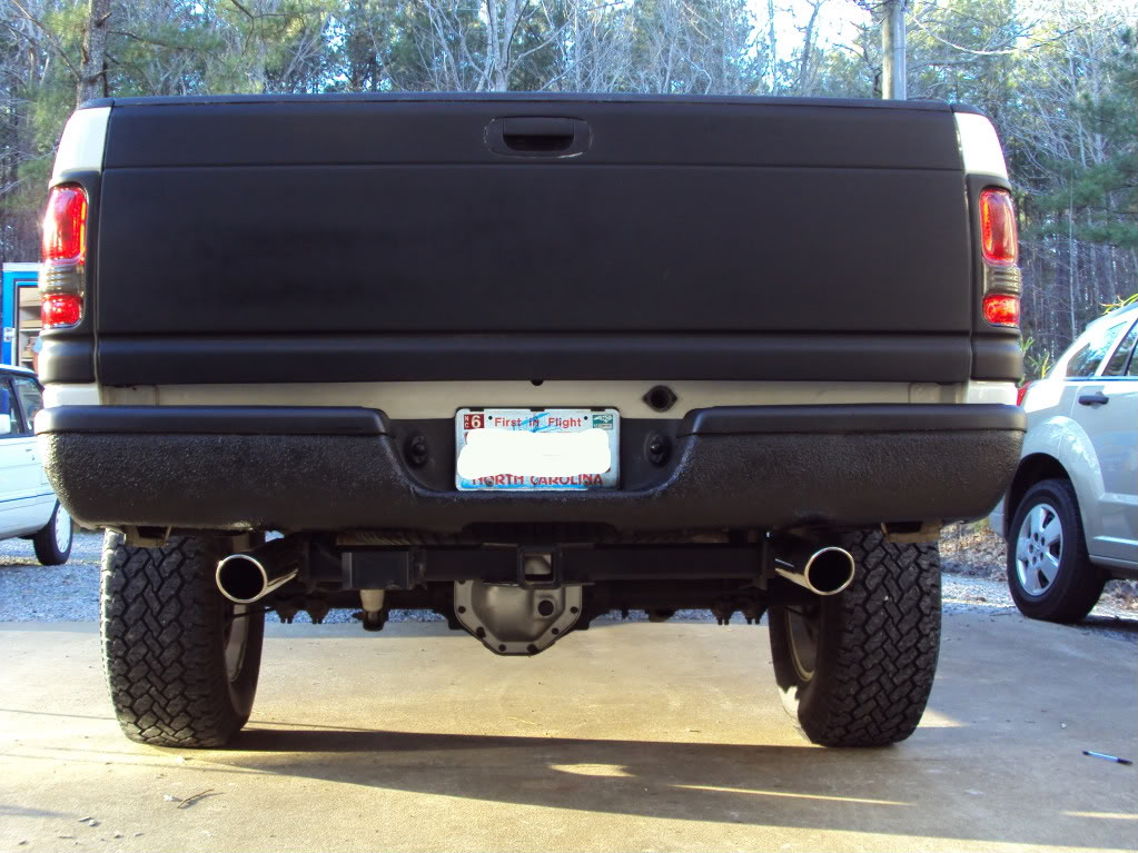

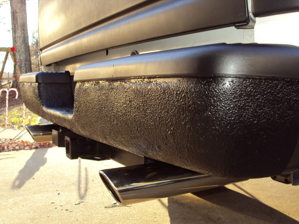

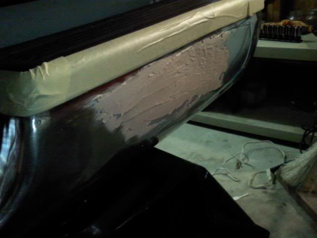

I decided to fix my dented bumper and test out Hurculiner in one shot. First I filled the dents in with some bondo (the picture is before I sanded it. I'm no dummy) After that was smoothed out to my liking and scuffing up the remainder of my shiny chrome, I applied two coats of the VERY MESSY Hurculiner. After drying for about 18 hours, I applied two coats of Duplicolor bumper and trim paint. I'm pretty satisfied with the results. Lets just see how it holds up.

Looks pretty sick. Prolly should have taken plastic off of bumper, then theres no need for tape. Buuuut, getting that plastic off is a PITA. looking good

Thanks, guys. And no, there wasn't anything wrong with my tailgate other than some rust under the old plastic cover. The black paint is only temporary. Soon it will be Line x to the level even with the top of the tail lights and white above that line.

love the rolled tiped exhaust....... bumper looks great

did you use the uv protactant stuff if not its gonna look like ****.And in that case if you didn't us it, get a can of dupi color bed liner and go over it you well still have the same txture but the dupi color stuff has a uv protaction in it and it looks good.
