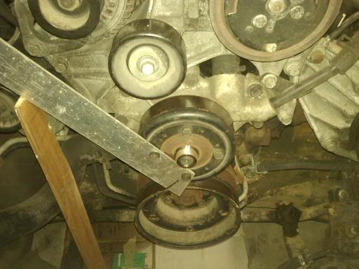

turn out to be normal threaded, strap wrench wouldnt hold so i did this,, was going to cut the piece of wood shrot but it worked

...lol thats a damn good contaption...
i had a hell of a time getting mine off. but then the air punch knocked it loose

That is a good one.The special tool that does the same thing cost around $100 at NAPA.
