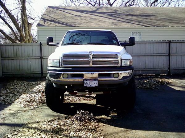

Here is mine I have a 5" skyjacker and 3" body with 37's. I would'nt go bigger than 37's on a 1500 unless you plan on upgrading your axles.

so when it comes down to it, a body lift is going to be the easier thing to do? im not really looking to swap mt axles yet so im not gonna be able to go past a 37'' tire anyways. im still interested in those custom control arm tho.
