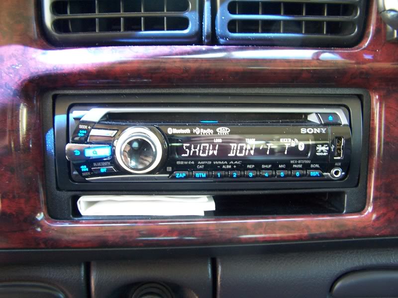

To the OP, the premium Infinity sound system has a remote amp turn on wire. Not sure if this is present in the standard radio. And aftermarket radios can look good when done right. This is mine:

It's not a matter of whether you're in violation of the rules, it's the fact that you feel the need to put in your 2 cents where no one asked and almost always in a negative way. No one asked for an opinion of aftermarket decks or for your commentary, but there they are in your post. Many members have complained of your attitude. As soon as you enter a thread it goes downhill and usually shifts away from the original question (much like this one now has). We are getting tired of it. If you can't help then stay silent or find a nicer way to express yourself without being so negative.
Your deck doesn't match at all IMO, but to each his own.
Good thing I didn't ask your opinion and really don't care what you think.
