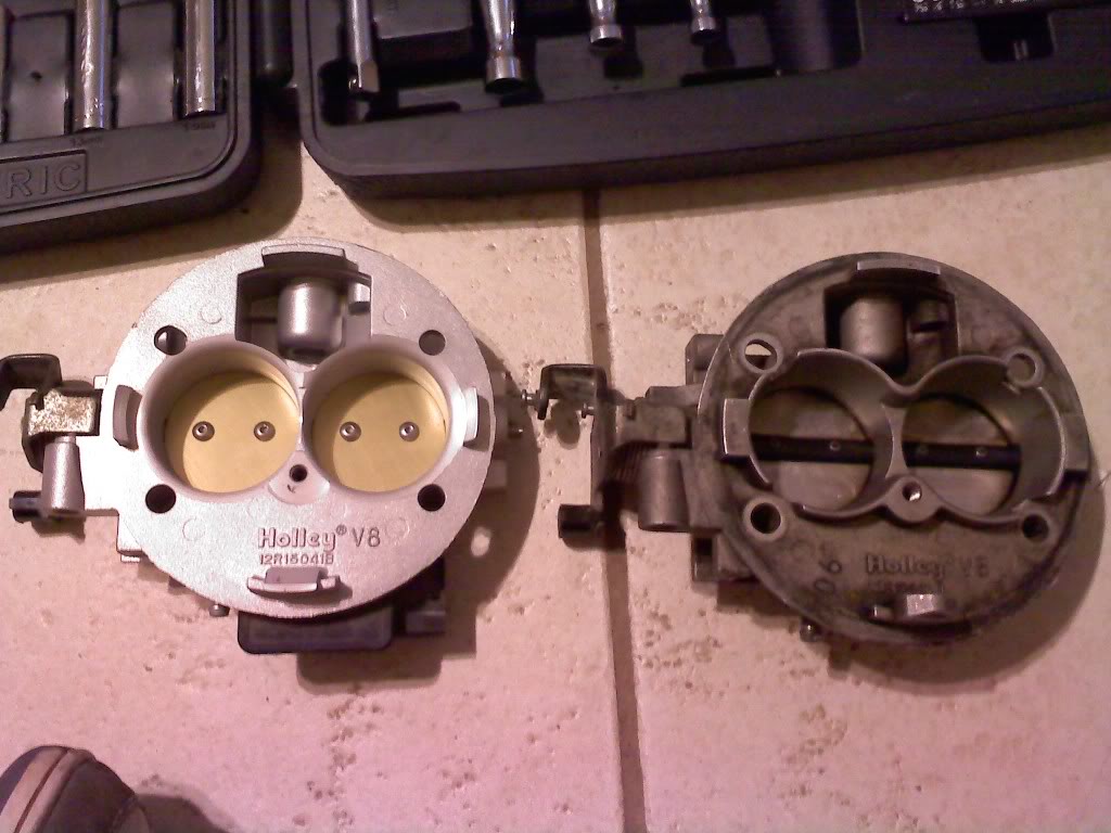

Okies so been having some starting problems, i seafoamed my truck today along with changing both positive and negitive battery clamps. put in a new IAC motor because the other one was COVERD in carbin and caused it to get stuck open, also ended up going ahead and pulling off the throttle body and giving it a good cleaning, didnt get it as clean as i wanted to but im going to be ordering a new holley later in the coming months when or IF i replaced my plenum and do a kegger mod.

Here's the holley throttle body, top isnt all that bad.
Heres the bottom which on the otherhand is coverd in crap.
Heres what the inside of the Keg looks like
Heres the holley again after i soaked it down with carb cleaner and whiped it down.
And the bottom, BIG improvement. There is still some burnt on stuff but it wasnt coming off.

i dont think ive ever seen the inside of a kegger look that dirty...WOW, you must have power loss, poor mpg's right?

Yep ongoing lol but i dont have the cash right now to put into redoing the topend, so im just doing small things to try and get by untill i start a new job

Ditto, that thing looks crusty beyond belief.
