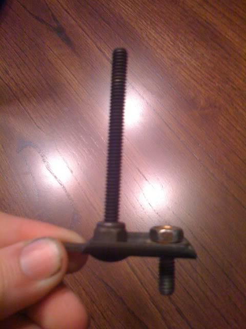

1. Go to a Junkyard and find an older dakota. It should have a circular air filter. Take the top off and get this:
2. Buy a circular air filter, they have a pretty nice Mr. Gasket at Advance Auto Parts. They cost about $27. I went with the K&N, and its great.

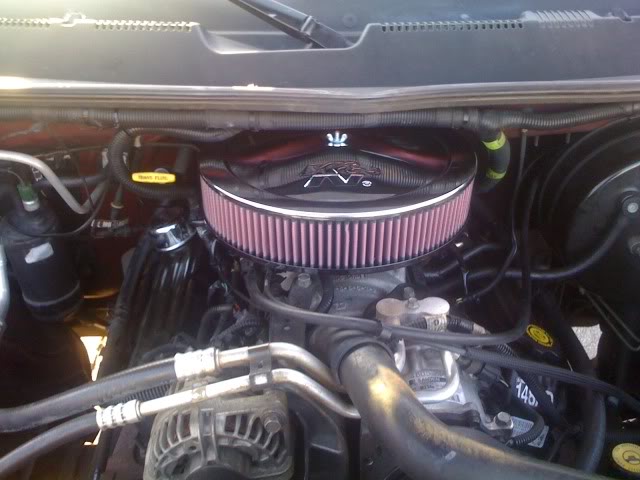

3. Go to the Doge dealer, and get a new air intake gasket. Its alot nicer than the one at the parts stores, and its real rubber. I reccomend putting some RTV on it.
