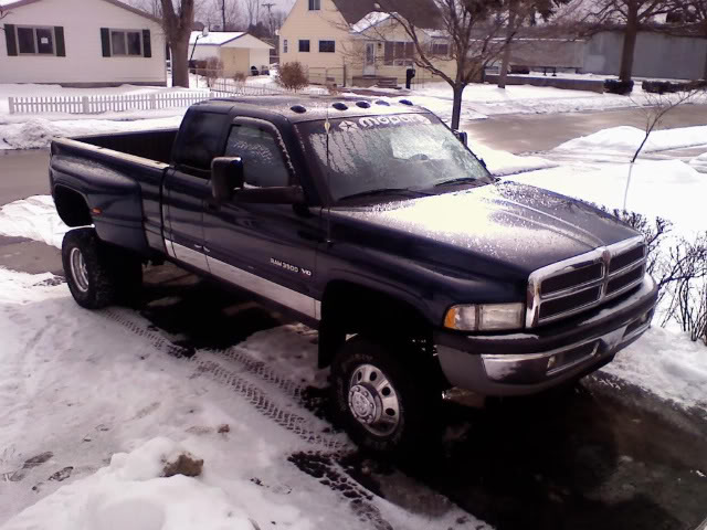

my truck came with that ugly stainless 6" trim on the doors has anyone removed it? if so how did you get that glue off?

Heat gun and a putty knife.

A plastic putty knife, you don't want to scratch up the paint.

Beware, many owners put that crap on to cover up rusted out doors and cab corners. You may be asking for trouble by taking it off.

yup all 3500s are duallys ....... i didn't think about the rust issue but then again theres not a spec of rust on the truck so i should be good
