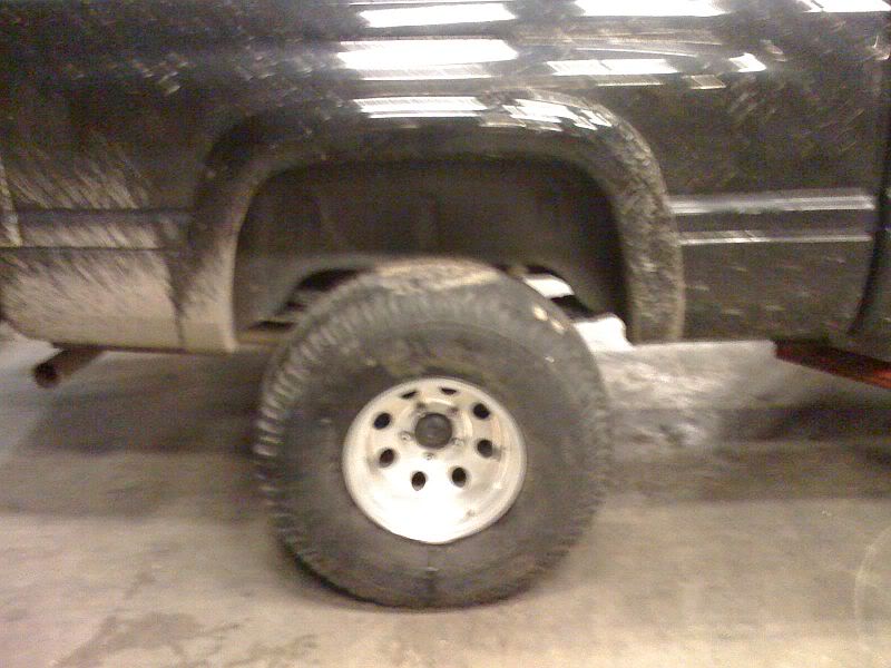

I have 15s on my 96 with 32's with 35's I had rub at full lock, the pics I have on here are of 33's
35's but this is on a car lift.
on 33's
33's while on the ground close up.

I had to put a leveling kit to fit 32 10.5 15 on my 97 and even at full turn i still rub a hair. but i had bushwacker fender flares on i took them off and I don't have that problem anymore. But it is still close.
