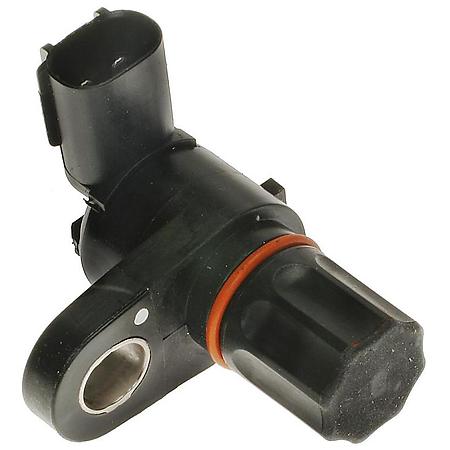

While removing the speed sensor on 99 Ram 1500 the whole sensor did not come out of the rear diff. See attached picture. Sensor broke off right at the red O-ring. So remainder of sensor is stuck in the rear diff.
Curious if any one has any idea how I might be able to get it out. And does any one know if it is possible of pushing the remaining piece down into the diff case (really dont want to have to pull the diff apart to get it out) or is it set to where it will not go in any further?
Thanks for any ideas.

just remove the diff cover and drain the fluid. remove the broken piece, clean the magnet, etc, reseal and refill. its good to service it every 3 years or so.

^ what he said, it's happend to me before and the easiest way to fix it is take the cover off and push it down untill she pops out

i had the SAME thing happen to me. I was able to get a scewdriver in there put tension on it and sort of "twist" it out...Wedge the screwdriver in it, and try to twist or pop it out. (didnt have to remove diff cover)

Screw driver trick worked perfect. Though it was going to be a lot tougher to get out but wasn't.
Replacement cleared check engine, ABS and break light in dash display. Also fixed speedometer to full function from before when it would only register speeds over 25 mph.
