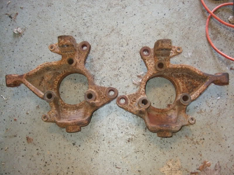

These are the knuckles that came off of it. They seem to look a little different than a '95.
Do these look like ones from a 2001 Ram?

The look very simmilar to my 2000 Ram. Did you get the calipers and/or thier mounting brackets?
2000 up Dodges used a dual piston brake caliper (bosch?) which is different from the Delco Moraine (GM) single piston caliper. The calipers will bolt up to your brake hoses, but you will need the mounts and appropriate hardware. They will help you stop better!
According to Dodgeram.org BOM #s for 1995-96 models are 610514, 610537, and 610512. the site doesn't list past 1998.
EDIT: I was able to find the BOM lookup on Dana's web site! Here is the link.: http://www2.dana.com/expertforms/deabill.aspx
According to Dana it is a 2001 axle.

I found a date stamp on the ring gear April, 2001.
No, I didn't get calipers or caliper mounting brackets with the axle. I wonder if I can get caliper mounting brackets at Napa or if they come with new/reman calipers.
Just saw that Napa does have listings for calipers with mounting brackets. Good to go now, thanks.
