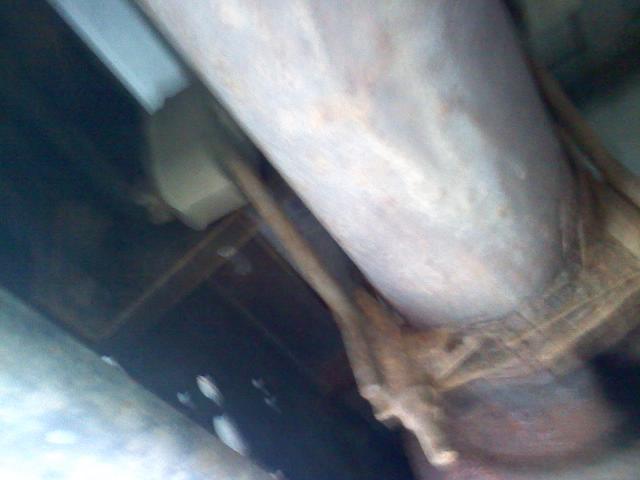

Just bought an 01 ram 2500 with a cummins and all the exhuast clamps are rusted out and need to be replaced from the muffler up. My question is on the clamp closest to the muffler it's got that bracket in the picture and I was wondering if there's a way to get the clamp out of that rubber and just replace the clamp or if I'm going to have to replace the whole assembly. Sorry about the picture I couldn't really get my cell phone in there to get a good picture of it.

take a pry bar and pry the rubber out of the hanger, take the bolts out. (impact works best) and you can use the same clamp just buy a new u bolt with the nuts.
