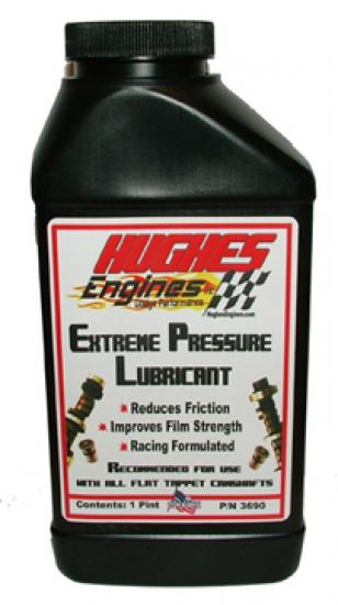

I started using this product from Hughes Auto and I have had really good luck with it.
EXTREME PRESSURE OIL ADDITIVE
Over the past 10 years or so all cam manufacturers have seen an increase in flat tappet cam failures, particularly in the high performance arena. We have spent close to a year researching oils and additives to try and find a product that could eliminate this problem. We have found it! Hughes Engines Extreme Pressure Lubricant is a state of the art additive package that is compatible with standard (mineral based) oils or synthetics. To complement this highly specialized additive package a proven friction modifier, Micron MolyŽ is further blended into the oil treatment. Micron MolyŽ is a liquid soluble type of moly that plates to the metal surfaces of the engine. Once plated, the moly forms a long lasting lubricant film which prevents the metal surfaces from coming into contact with each other. By preventing metal to metal contact, damaging frictional wear is eliminated, which leads to less downtime and longer engine life. This additive should be used with all flat tappet camshafts. We suggest using this with your break-in oil and at every oil change. One pint will treat up to 5 quarts of oil.
Part of the problem with all the oil that we use in or vehicles is they (our brilliant government) have taken all the zinc out of it.
I switched over to Amsoil 10w 40 premium High zinc. You will notice the difference.
