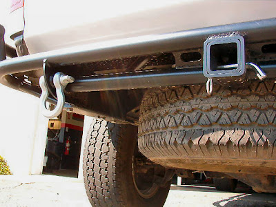

If it were me... I would have a receiver tube welded onto the tube bumper you are making. Something along these lines:
You would have to make sure the way the bumper mounts to the frame is secure - but I would trust that setup a lot more.
