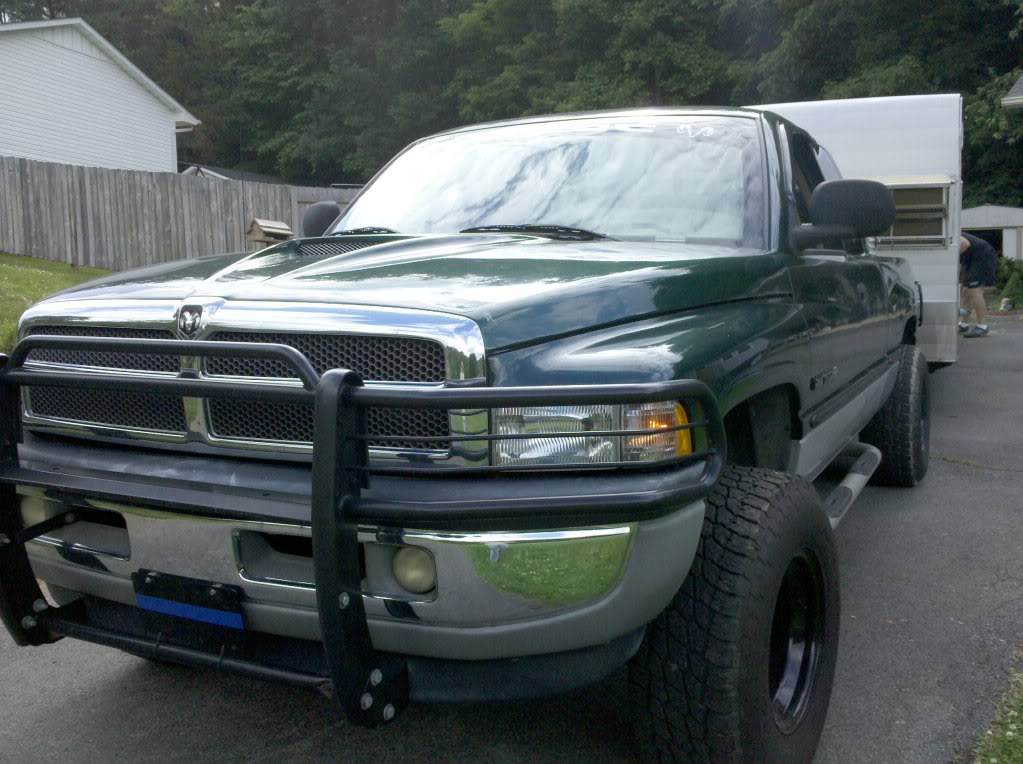

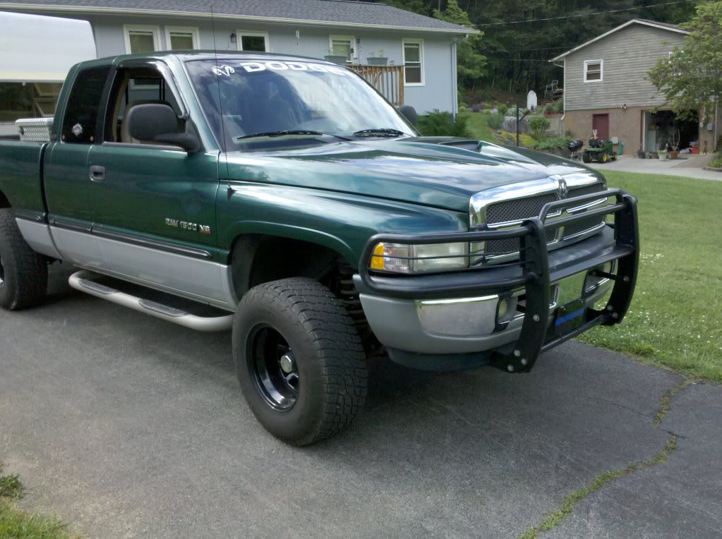

been busy the past day or two but here are a couple pics i took today of the truck
yes thats a police tag
the hood thats on it is an actual cowl induction hood so the 14x3 air filter will work great...
any ways what do u all think

looks good dude! I like the brush guard and hood
about the plenum, take the airbox off and look down in there with a flashlight. If you see oil, plenum's gone. Also, if you have one of those telescoping magnetic pickup tools, stick that down in there and see if it sticks to the plenum pan. If it sticks, it is the stock steel plate.... We are plenum geniuses around here lol

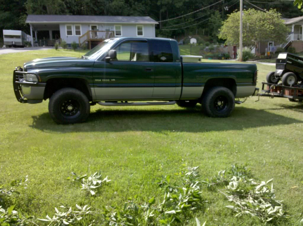

well i drove the truck to my dads sunday and found out that it hasnt had the plenum fixed because u can hear it pinging....
fuel mileage isnt that bad... 11.3mpg
so maybe it will be better after i fix it....
i took another picture too
i had to trim the apple tree coz the branches was blocking the view when backing out of the driveway....
ill cut it down eventually...
