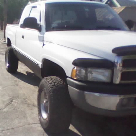

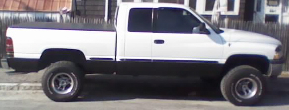

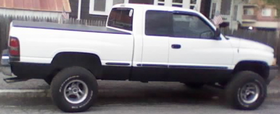

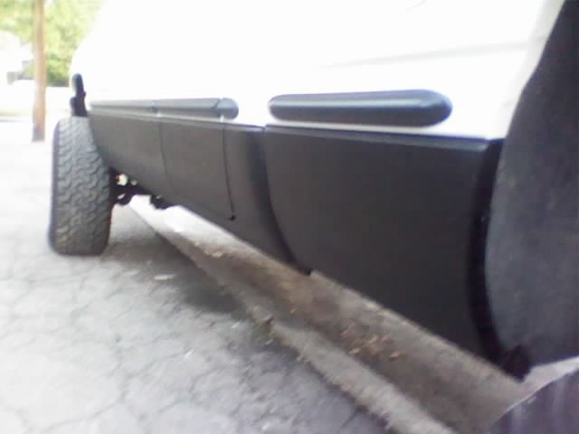

i did my rocker panels about 2 weeks ago, using the rustoleum roll on bedliner. prep was done w/ an orbital palm sander and 120 grit sandpaper.
i had the typical rust on the bottom of my doors, fortunately it was just on the surface. i brought those areas down to bare metal and used a primer/sealer.
after thoroughly scuffing ALL the areas getting liner, i taped off the lines w/2" painters tape and applied 2 coats per side using a 6" foam roller and regular trim brush.
the surface is slightly textured, but doesn't appear at all as rough as herculiner.
there are some spots with faint roller/brush marks...but you can only see them upon very close scrutiny.
i plan on spraying a finishing coat w/the rustoleum can version in the near future & i think that will remedy any imperfections.
i'll keep you posted.
sorry for the poor quality pics...cell phone cam.

i had the grey trim too.made taping off real easy.
i'd also like to add that i did NOT remove the rear bumper to do this...i taped it off real good and made "tubes" of paper to go over my tail pipes.
removing the bumper and trailer hitch seemed like a project in and of itself....but i managed to get the liner on w/the brush from the side, top, and underneath.
total of about 7 hrs. taking my time...including removing the mudflaps which were a real P.I.T.A... P.O. used all types of assorted hardware. in the end i just sacrificed and cut the flaps and bolts, screws and clamps.
