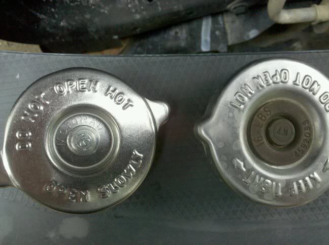

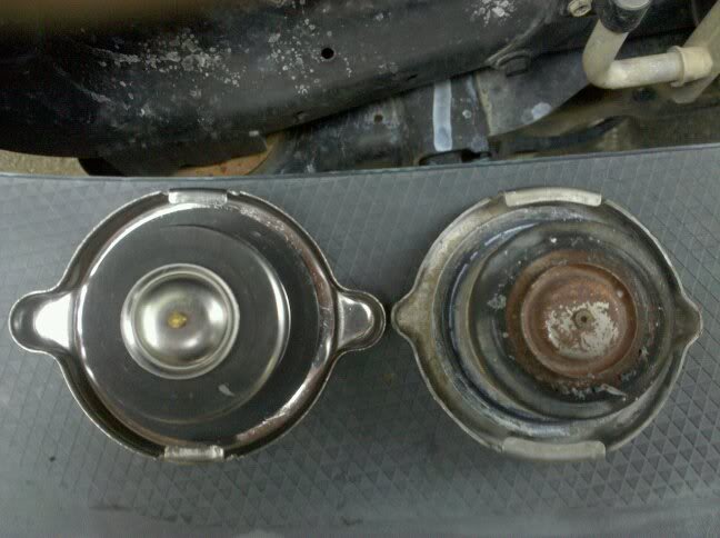

Ok so I finally had time to go grab a new car and man what a difference in the gasket size. I took some pics to show you guys.
now is it just me or does those two caps look different? the new cap fits a lot more snug. Might just be the gasket but im kinda thinking the old one was too small to begin with.

you want it snug,
it's holding 16 psi.
