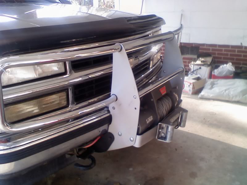

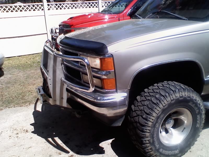

While we are on the subject of grill guards, here is a little project I did in April. A buddies chrome Warn model had the chrome peeling off his uprights. At seven years old, about 50% of the chrome was gone. Rust and severe pitting had set in.
We had a local shop sand blast them for $40 and then I primed them. Had to use quite a few coats and sanded the hell out of it to bring the deep pitting up to level. Then we ordered some Dupli-Color in his trucks GM Metallic Pewter and I painted them with four coats and two coats of clear.
Came out pretty good I thought. Not a perfect match to the truck as the truck has been in the south Georgia sun for over ten years, but not bad! Painted his black winch mount to match as well.
Curiously, the hoops and center bars are also chrome and in perfect condition? Glad mine is stainless though!
Now he's trying to get me to color match the bars/hoops and take off his bumper and paint it as well to give the look of an all-in-one heavy duty front end. I told him they don't make enough beer for me to undertake that job!!!
